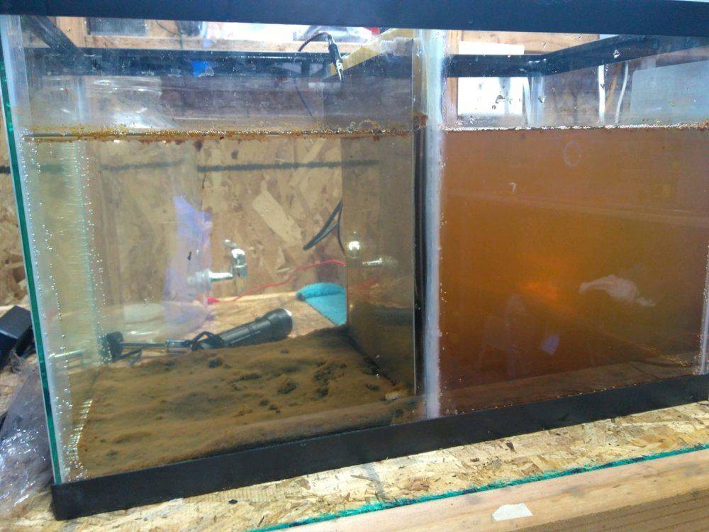

Good day,
I am here because I have begun a new hobby and it is my hope to better understand what it is I am doing and seeing. Luckily I have the mental capacity to process much of what I read, but sadly I am vastly under-educated. My new project involves electrolysis and for reasons I don't understand the water can turn black (see images)
To begin I am ionizing water with a membrane (chamois) in the center of the tank. This works effectively as I can see the difference in the water as oxygen bonds are broken and hydrogen bonds are broken. I run this ionization process for about 24 hours before I drop charging plates in the negatively charged side for a couple of hours and then the positive side for a couple of hours. I then let the particles in the water settle for 24 hours. The negative side will remain clear with debris on top of the water and much debris gathered at the bottom of the tank. I then drain both sides equally, clean the tank and repeat the process.
The last stage involves me recombining both the positively charged and negatively charged waters and once again throwing a 2 hour charge on the water. This is where I run into my problems. Everything appears to be ok and all of my sample waters turned out fine with the particles separating and dropping to the bottom, but when I do the bulk water my water always turns black. and will not separate with electrolysis.

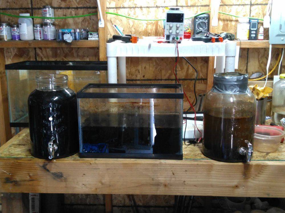

My only solution thus far has been to run a fish tank pump for a duration of time to filter the water enough that I can use a carbon filter to finish the job. In the end I end up with negatively charged water and didn't have to pay thousands of dollars for a machine on the market. The image with the major mineral build up on the left is only visible because of the 2500 lumen light. The other image is what I see normally.
I forgot to mention this is spring water with no electrolyte added.

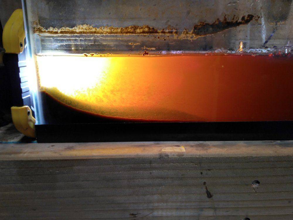

The black material is probably an oxide/hydroxide compound of whatever metal you're using as your electrodes.
Are your electrode getting etched or corroded?
This would be expected if material in the water were being derived from the electrodes.

How is it that 1 amp can strip that much 316L stainless from from my .083 plates. Also when I am done processing the water I freeze samples where the top of the ice cube is clear like gas and the bottom is cloudy like crystals formed around particles in the water.

See the picture below Hydrogen ionization is happening on the cathode side. Not mumbo-jumbo, half of physics is built on unproven theories.
Ionization basically means converting something into ions - either by removing or adding electrons, or by splitting larger molecules into charged parts. Water molecules get split in a process called "autoionization" - so some ions are present always, even in the purest water samples (so called ultra pure water, or 18 MΩ water - after its specific resistance).
How do you "see" the difference, and how do you know the bonds are broken? Molecules are way too small to be observed by a naked eye, so at best you observe some secondary effect and interpret it as bonds being broken. But how do you know your interpretation is a correct one?
The part of the tank of the left was the cathode side and the right was the anode side. It is self evident that the cathode side is breaking bonds with whatever minerals are in the water.
As I said earlier - it is evident that something is different on both sides, but I would be very careful with assigning the change to "breaking bonds". Breaking bonds has a rather specific meaning - it typically means splitting the bond inside a molecule, converting one substance into another, simpler one (which can, and often will, react further). It is self evident water in both parts of the tank has different amount of substances dissolved, but your conclusion about "broken bonds" is way far too fetching.
If I can suggest something - try to find some introductory text (like High School textbook) and read it. At the moment you have a lot of enthusiasm, but you tend to misuse nomenclature and you fill the gaps in your understanding with guesses. In my experience that's a disaster waiting to happen, sooner or later we will have enough of trying to guess what you really mean and you will think we are purposely not helpful.
You didn't answer @BillTre 's question. Does it look like material is being lost from the stainless steel plates?
themerge said:
then I take 4 6x6 plates and run them for two hours on each side.
What does "on each side" mean? Don't you immerse the whole electrode in water? If it's steel, the entire electrode will be at the same potential, i.e., it won't have a preferential "side."
You have probably produced hazardous materials. Stainless steel contains chromium, and at the anode it can get oxidized to Cr(VI). It seems that stainless steel is still often used for electrodes, but I think only with a suitable electrolyte, so the electrons from the electrolyte will be removed, and not from the iron and the chromium.
