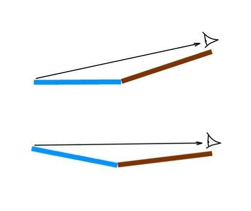

Is it not just because our sense of what is actually 'horizontal' is not very well developed? There is really no reason why Evolution would have given us the ability to resolve such small angles. Certainly, nothing that we experience in a smoothly rolling motorcar will be familiar with our basic senses. Let's face it, it was only when Newton came on the scene that people had much idea of such things at all. We get all our clues from what we can see and that's dominated by nearby things.
There aren't many visual clues to distinguish the difference between the two cases...
Heh heh. There is one big visual clue. There's an ocean there, and you know it's pretty close to level.
But seriously, good drawing.

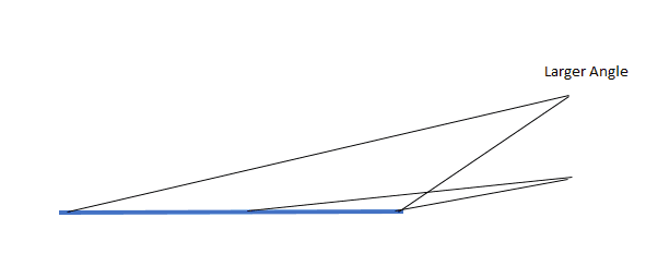

There is an additional thing going on because you are at altitude. At higher altitude, the horizon is at a larger angle to the near edge of the water. This is both an effect of perspective, and because you can see farther. When the apparent distance to the horizon is larger, your brain wants it to be higher, not farther away. Because you have to raise your eye line more to look at it.
