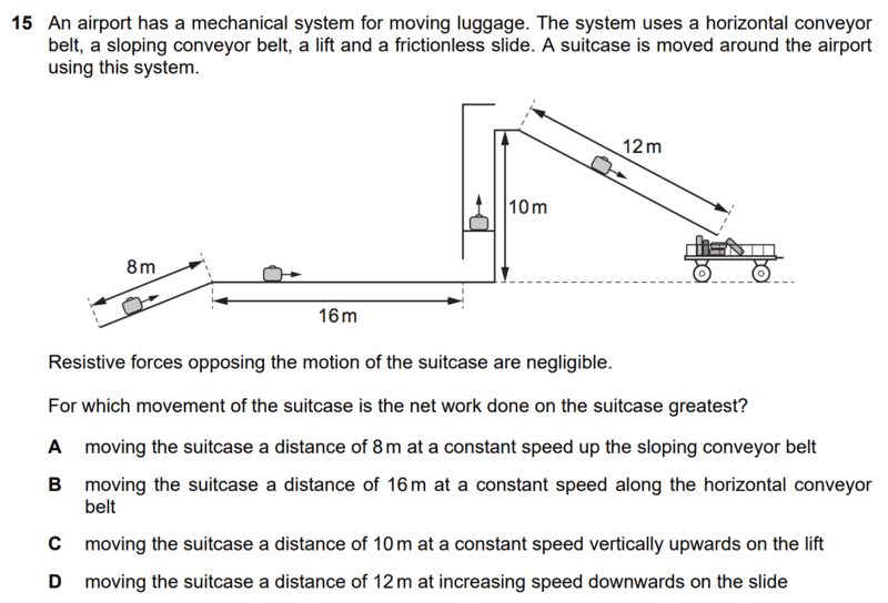

How Is Work Calculated on a Conveyor Belt with Friction?
hello478
165
correct answer is c
w=f*d
my answer was c
but i didn't understand why the work done in 16m or 12m wont be the greatest?
how would we calculate work done in 12 m and 16 m??
Likes Gordianus
hello478 said:
Homework Statement: correct answer is c
Relevant Equations: w=f*d
my answer was c
Let’s look at the 16 m section. How do you calculate the work done by the conveyor on the suit case? In other words…is there a force that is carrying it along? Think carefully with respect to the assumptions of the problem (there are no forces like "air resistance" pushing it the opposite direction) and the fact that suitcase moves at constant velocity. It can be a tricky thing to catch, because it is an ideal scenario...something we never experience first hand. However, if you apply Newtons Second Law, you will see what the answer must be.
Note that the problem is asking for the net work, i.e. the sum of the works done on the suitcase by all the forces acting on it. There is an equation that relates ##~W_{net}~## to ##\dots##
Likes erobz
You have to distinguish between work done on and work done by.
The work done on an object is always the increase in its KE, so in all those stages of constant speed no work is done on it.
This is the same as the work done by the net force, but individual forces may do various amounts of work. E.g. in the first stage, the belt does some amount of work W, but gravity does work -W, for zero net work.
One niggle: on the first ramp, in practice, the case will start from rest, so a bit of work is done on the case.
Likes MatinSAR
for the 16m part of the slide, how do i know which force to use, how is the force acting towards the right?
and what about the 8m?
and i dont understand where the newtons second law is it to be used...
As I wrote in post #6, you don't care about the individual forces. For finding the work done on a body you only have to consider its change in KE.
Who said it is? Looks to me that no force is needed in that stage.

hello478 said:
so, now i know that there is no force acting at 16m
You know there is no net force because if there were the case would accelerate.
The instruction to ignore resistive forces is redundant. In practice, the belt would exert a horizontal force in order to overcome air resistance, but since those balance this does not lead to any work done on the case.
Likes MatinSAR and erobz

hello478 said:
how do we know its not accelerating?
Read options of the test.
but like there is no other hint of it in the question, right?
Yes. These conditions (constant or changing speed) are stated in options so you can compare them.
so, in 16m, its moving at a constant speed... which means no change in speed, and no KE
but what about work done?
is it 0? because no net force so 0 work?
Do you know about Work and Energy theorem? Use it.
that energy = work?
but first tell me if this is correct...
work done is 0 because there is no net force...?
also if there is no net force how can the box move??
Because it’s not accelerating. Notice when you ride in the car, do you feel a force pulling you along when you are moving at a constant velocity? It’s not until you accelerate forward that you feel the normal force from the seat pushing you along. Likewise when the brakes are jammed you are thrown forward.
or is it because there is no change in KE?
  • #31
hello478 said:
ok and can you please answer this?
The net work is 0 because there is no change in KE( or visa-versa)
Likes MatinSAR
  • #32
erobz said:
The net work is 0 because there is no change in KE.
work done is 0 because there is no net force so w=16*0 ... so this explanation is wrong?
  • #33
Conceptually It’s important that you say there is no net work done. If there are other forces like air resistance and static friction from the belt that are in balance the there is no net work done on the box, but the air resistance would be doing some work, and the belt( through friction) would be doing work also.
But otherwise yeah, no net force means No acceleration, no acceleration means no net force.
  • #34
sorry for bothering too much but the question says to ignore them... so it would be correct, right?
  • #35
I just didn’t want you to be confused about this later on.
Likes MatinSAR and hello478
