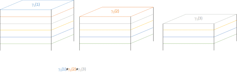

Hello,
Using surface energy dependence on surface orientation it is possible to predict equilibrium crystal shape by applying Wulff construction. But I faced the problem when the surface energy depends not only on the surface orientation but also on the surface depth or surface termination and depends significantly.
So, usual Wulff relation
∑γisi=min
becomes
∑γi(rj)si=min
where γi(rj) is periodical function of surface energy γi upon the depth rj.
How it is possible to correctly apply Wulff construction to this case?
Thank you!

Yes,I agree with you. But how should I choose the γi(rj)? Should I choose maximal or minimum value (which will depend on P,T, etc.), or something else?
I'm not sure I understand the depth part of your question. Do you mean the the thickness of the thin film (or the slab model in a computational model)? Or let's say the size of the nano particle you are trying to study?
At any rate systems try to minimize their free energy. And in order to do this properly, you need to compute/measure the surface energy (or better free energy) for each surface (h,i,k) and use the termination that minimizes the surface free energy in the sum you indicated above for the Wulff construction.

Thank you for the answer and sorry for the misleading (I expected that term "depth" is vague). I talk about surfaces, not slabs. The surfaces with same orientation (a⋅h,a⋅i,a⋅k) for a=1...N has different γa, whereas application of usual Wulff relation requires γa=const for the same surface (h,i,k). Please find the graphical representation of the problem attached to the message.
Thank you for explaining this by a schematic, it made it much clearer. I always thought that the surface energy of (001) is the same as the surface energy of (002) or (003),... Please could you give an example, where this is actually not the case. A specific material with certain crystal structure will help orienting the discussion.
