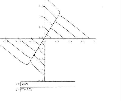

x' = y-2x
y' = 2x-y
Whenever you look for equilibrium points x'=0 and y'=0, y=2x for both cases. What is the meaning of this outcome? Infinite equilibrium points?
That means that, rather than having "discrete" equilibrium points, every point on the line y= 2x is an equilbrium point. Yes, there are an infinite number of equilibrium points. That also implies that the determinant of the coefficient matrix,
[tex]\begin{bmatrix}-2 & 1 \\ 2 & -1\end{bmatrix}[/tex]
is 0 and so one of the eigenvalues is 0. If you were to look for an eigenvalue corresponding to eigenvalue 0, you would find <1, 2> or y= 2x. That is, there is no "motion" along the line y= 2x. It happens in this particular case that the other eigenvalue is -3 and its corresponding eigenvector <x, -x> which we could think of as flow toward y= 2x from both sides.

But maybe you should picture the entire situation more completely (or correct me):rolleyes:. I'm understanding by x', y'. dx/dt and dy/dt.
Over all the plane you've got x' = -y', that is dy/dx = -1. So from every point above the special line the point will travel in time at a downwards 45° angle. From below the line it will upwards in the opposite direction to that. Neither normal to the line. It will travel slower as it approaches the line and never pass over it. I think all points on any line parallel to y= 2x are traveling at the same rate.
Over all the plane you've got x' = -y', that is dy/dx = -1. So from every point above the special the point will travel in time at a downwards 45° angle. From below the line it will upwards in the opposite direction to that. Neither normal to the line. It will travel slower as it approaches the line and never pass over it. I think all points on any line parallel to y= 2x are traveling at the same rate.
Yes, that is also a good point. In fact, it is easy to see that every point on the line y= 2x+ b, for any b, that is every point on any line parallel to y= 2x, is moving toward that line at the same rate. You can think of that as saying that the entire line, y= 2x+ b, is moving toward the line y= 2x with its speed slowing as it approaches that line.

In your example your final equilibrium point (Xeq, Yeq) on the Y=2X line, though not the ratio, depends on your initial conditions, in other words on the total amount (X0 + Y0) of reacting stuff that is there. You'd get a single stationary point, like you had been expecting, at (0, 0) if you introduced an additional irreversible reaction [tex]Y \stackrel{k_{yz}}{\rightarrow} Z[/tex] .
Then you've got
X' = -kxyX + kyxY
Y' = kxyX - (kyx+kyz)Y ...(eq.1)
(An equation for Z' would be redundant because of conservation of mass). No longer is the determinant of your 2X2 matrix 0. Your previous equilibrium line is replaced by another strong line - the characteristic or eigen- vector to which the phase paths tend - see fig 1 (phase paths are now a bit more informative) which is the typical pattern when eigenvalues are real negative. (For the given chemical example everything happens in the positive quadrant of course).

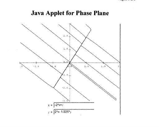

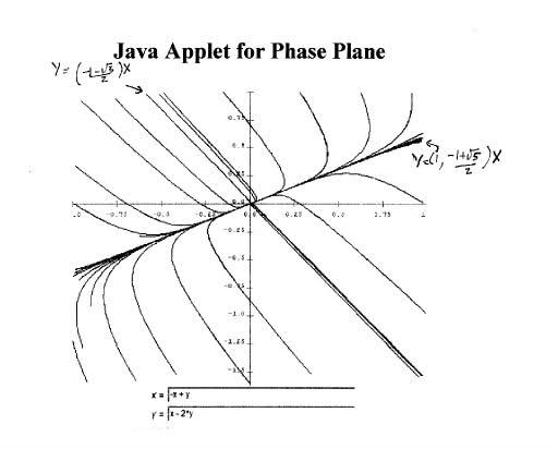

This pattern morphs towards one that seems to resemble your original problem as you make kyz small, understandably. See figs 2, 3. What is happening there with small kyz is that X and Y interconvert to close to the equilibrium ratio then your point slowly creeps down in a path near the eigenvector to (0, 0) as Y slowly converts to Z. As kyz gets small the eigenvector gets close to the equilibrium line and the isoclines get close to the eigenvector too.
It would be instructive if this is what you are on to now, to solve eq. 1.
Instructive too to work out the eigenvalues when kyz is small and see that one becomes close to -(kxy+kyx) i.e. the same as above for the mechanism without the Y -> Z step, which makes sense. Slightly more difficult, you can work out that the other eigenvalue is approximately – kxykyz/ (kxy+kyx) . That also makes sense because it equals -kyz which would be the eigenvalue (constant in the exponent in the exponential) for the simple process of disappearance of Y in reaction Y -> Z multiplied by the fraction Yeq/(Xeq + Yeq)of Y present in (X + Y) .
