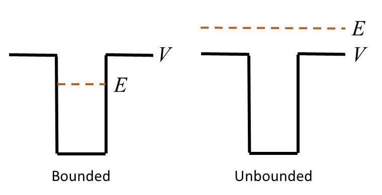

Here's a simplistic illustration. The figure on the left is an example of a "bound" state, while the figure on the right is an example of a "free" state where the particle has enough energy to NOT be bounded to the potential.

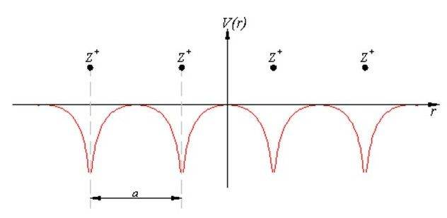

In a conductor, it is a bit more complicated, because now you have a periodic potential that can be approximated to look like this:
This is the Bloch periodic potential, and when you solve for the wave function, you get the Bloch wave function. Notice that the wave function is a superposition of plane waves! This looks nothing like the wavefunction that you solve for a bound electron in a central potential.
