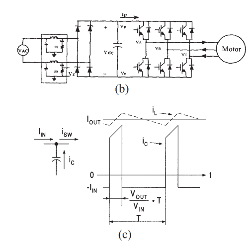

That's significant in power supply filter capacitors where the charging current flows only in short gulps near the sinewave voltage peaks so is very peaky.
Every capacitor has a rating for RMS ripple current .
image courtesy of http://www.cde.com/resources/technical-papers/selectinvcap.pdfold jim

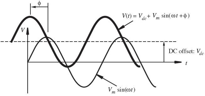

We typically think of RMS as exactly that, square root of the mean of the squares, it is a calculated value based on the wave shape, regardless of that shape, for example in DC-DC you often get a step ramp (inductive power transfer), if zero current switched, then its a portion of a triangle wave, RMS still applies as long as its a resistive component (wire, FET rdson, ESR of capacitors etc).
Note I would call the waveform you are describing an AC waveform with a DC offset.

Imagine you have a True RMS Voltmeter ,
and use it to measure a signal composed of AC with DCoffset
Does the meter have a series capacitor to block the DC component and report RMS of just the sine wave?
Or does its report include the additional heating effect of the DC component too ?
I can see how someone in a hurry might ascribe the name "DC RMS" to the latter behavior
but he should define his term unambigupusly.

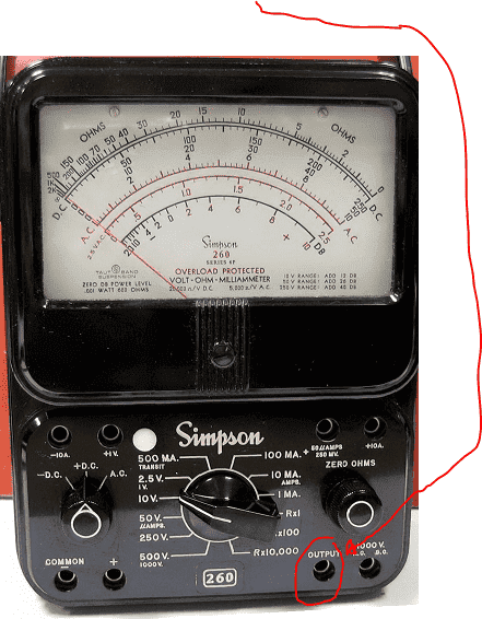

Tonight i'll connect my True RMS Fluke to a flashlight battery and see what it reports on AC scale.
The venerable Simpson 260 includes a capacitor that you can use to block the DC component of such a signal..
You plug the red lead into the "Output" jack.
