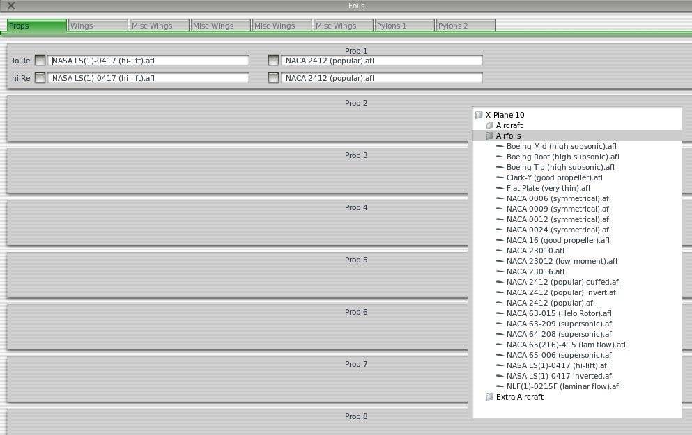

One thing to consider is that the wing profiles used in most modern planes are publicly available. They were the result of NACA's early studies into wing types. In...32...I think, the Govt ran a comprehensive study to determine the best wing shapes for different speeds & altitudes. Many of these NACA originals are still in use. They are also available in Xplane (for both the wings and props) so you can really go crazy with different configurations. The Xplane builder is klazy-cool. It's like a laboratory for flying. Burt Rutan used Xplane when he built his Spaceship1 simulator, and the software was so accurate that they actually made changes to the control system based on data harvested from the sim.
Image from my twitter account, pulled from screenshot, Xplanes 10.
