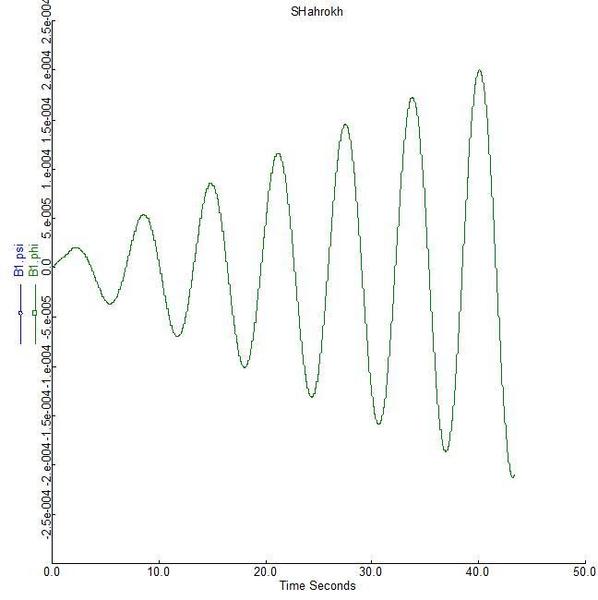

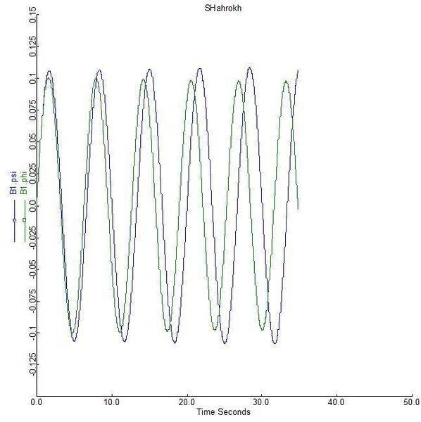

If I just let my integration tool run with invented values
Code:
eps  as realparameter (0.1)  ;
lambda  as realparameter (1)  ;
s_sigma  as realparameter (1)  ;
phi  as realvariable (initial, 0)  ;
psi  as realvariable (initial, 0)  ;
dphi_dz  as realvariable (initial, eps)  ;
dpsi_dz  as realvariable (initial, eps)  ;
$phi = dphi_dz  ;
$psi = dpsi_dz  ;
$dphi_dz = lambda * phi * (phi^2 + psi^2 - s_sigma^2)  ;
$dpsi_dz = lambda * psi * (phi^2 + psi^2 - s_sigma^2 + eps/lambda)  ;
I get
for eps = 0.1 and
for eps = 1e-5
It will be quite a job to use a shooting method (*) and get the boundary condition fulfilled...
