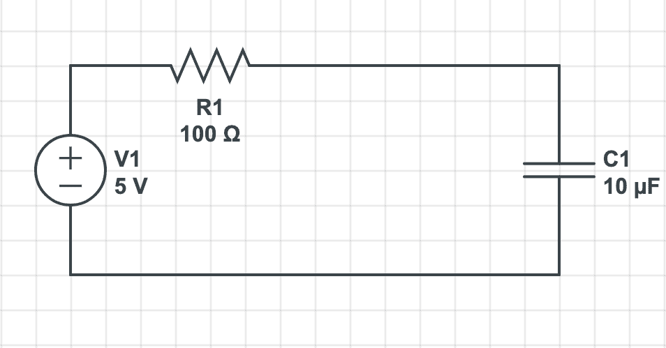

I get the practical difference between the two circuits, but can't really understand why
(Pictures below)
Schermata 2020-11-04 alle 08.15.26.pngCircuit A(RC) Schermata 2020-11-04 alle 08.19.16.pngCircuit B(RRC)

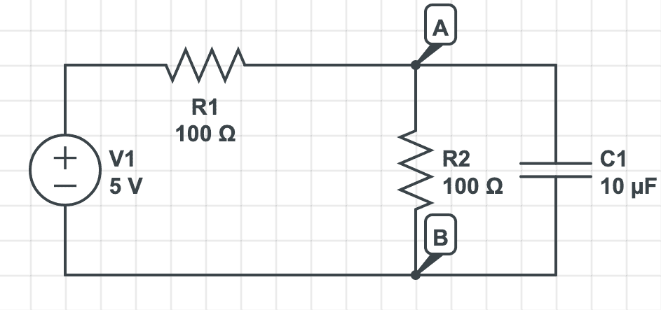

Hi guys, the thing I don't get is why the maximum charge of the A capacitor is ##q_{0}=C\cdot EMF## whilst in the other case you must consider the drop in tension caused by the first resistor, so the maximum charge of the cap is ##q_{0}=C\cdot (EMF-V_{R1})##.
Aren't the ends of the capacitor subject to the same potential difference in both cases? And since the charge is proportional to voltage and capacity, shouldn't it be the same in both cases?
I'm not sure, whether you talk about an AC or a DC circuit. From the drawings I guess it's DC.
Then you just need to use Kirchhoff's rules for time-independent fields. For circuit A there's no current and the capacitor voltage equals the applied voltage, i.e., ##U_{\text{C}}=V_1=Q/C## (with ##Q## the charge on the capacitor).
For circuit B Ohm's Law tells you that there's a current through the two resistors, ##I=V_1/(R_1+R_2)##. Then taking the line integral of ##\vec{E}## along the loop containing the resistor tells you that ##U_C=Q/C=I R_2=V_1 R_2(R_1+R_2)##.

Oh okay, got it!
So it's just a matter of considering the circuit in its "final stage" when the capacitor is fully charged:
in circuit A, there will be no current flowing, whilst in the other case, there will still be a current flowing through both resistors, causing a drop in the tension applied to the cap.
Am I right?
Likes vanhees71 and Delta2
Yes, exactly. If it's considered an AC problem, you have to write down the corresponding differential equations and solve them for the given initial condition.

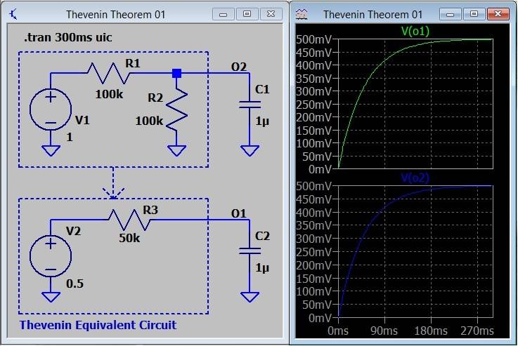

For similar circuits, Thevenin's theorem can be used to simplify the calculation of the transient response of the voltage across the capacitor.
