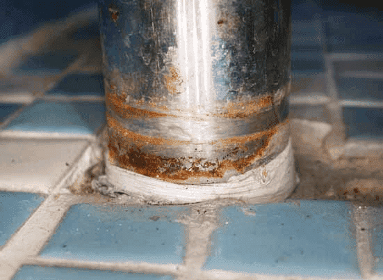

Tell me if this stainless steel is "non-reactive". Unless they are put into perfect vacuum, there are no stainless steel that will not corrode. They will corrode in water, they will corrode in air, one way or another.
