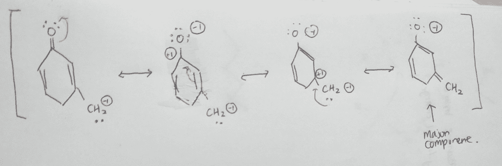

For the ion shown below, draw the most important resonance forms and predict which resonance form is likely to be the major contributor.
none
ion shown:
My answer:

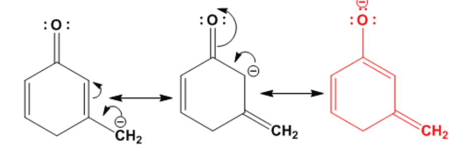

the following is the answer of the question:
I identified the major contributor correctly, but the resonance structures, but the second resonance I drew is missing in the answer sheet.
Can anyone tell me why the second resonance structure is not part of the answer?
Thank you
Same reason as before. Question asks for the most important resonance forms, not every possible one.
Likes docnet
There would be quite many hexagons to draw, if you drew every single one.
