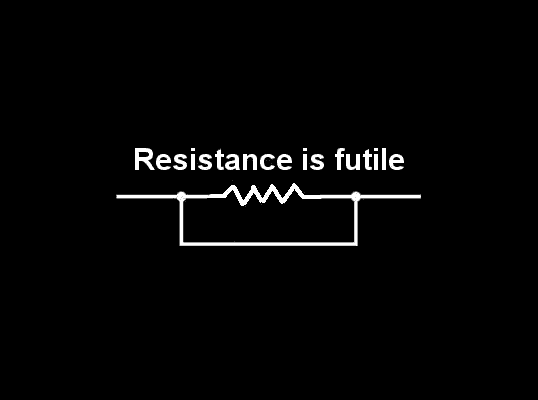

There is a direct cable from one side to the other. What do you expect?
I would say electrons choose the path of least resistance, and therefor never even attempt to go through the resistances. But I know that's extremely wrong, so I won't say it. In all honesty man, I have no idea.
Correct.

mfb said:
Correct.
As image:
Hahaha, I want that as a shirt now to be honest!

Think about the image in #4.
Although your statement about current taking the path of least resistance is not accurate, your conclusion below is correct (since the wires are assumed to be ideal).

How many paths can you find to go from the left terminal to the right terminal? Which of them is the path of "least" resistance? How much is that least resistance?

If you understand the circuit in #4, you can use it to get rid of R1. And then you can use it to get rid of R2. What is left?

4 paths. 2 at the start, and then each path has another 2 'sub-paths'. the least resistance is the path through the wire alone.
Yes, and how much is that resistance?
Speaking in term of ideal circumstances; 0 Ohm.
Right.

Would the equivalent resistance of the Figure simply be 0..?
Yes.
