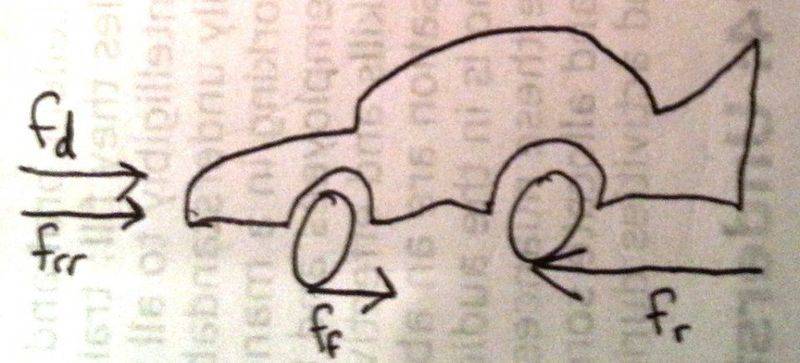

I'm building an excel dragstrip model. I already have a working model that incorporates force exerted at the rear tires, force of drag, and force of rolling resistance. Now, I want to take into account the linear force that acts on the front tires that is required to accelerate them. There is both a linear component and an angular component. The linear component is already accounted for, because the mass of the wheel, tire, brakes, and spindle are included in the overall mass of the car. The angular inertia of these components is not accounted for.
I am not a regular here, and am not good at typing stuff out. I did some beer math and a free body diagram, and am surprised at the result. I have never seen it calculated this way, and have searched google all day to no avail. Please confirm or shoot down my work. Thanks!
All of the other forces are independent of angular acceleration, but the force at the front wheels, "ff," must be calculated as part of the acceleration equation.
equation 1:
fnet=mc*a, where mc is the mass of the entire car, and a is the total acceleration of the car
equation 2:
fnet=fr-fd-frr-ff, where the forces are defined above, and I prefer to use the absolute value of the forces, but I couldn't find the abs val symbol. So I will treat all forces with positive values that should be subtracted if they act against thrust, or fr.

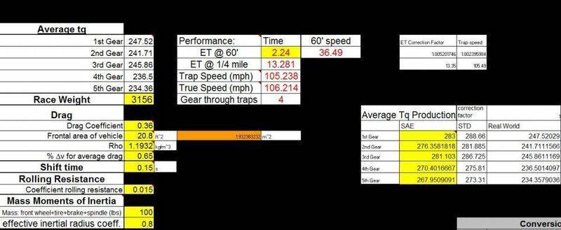

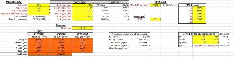

BTW, here are couple of shots from the model inputs and outputs. I've scaled my car, and put it on the dyno. Then I took it to the track two days ago and ran a:
60': 2.2422
1/4 ET: 13.35s
1/4 Trap: 105.49mph
All I could find on google or elsewhere on the internet regarding angular velocity, acceleration, and the like were kinetic energy formulas like 1/2*mv^2, and others that substituted I for the mass, and angular velocity for v. I also found several integration formulas, that I didn't try to use, because my model treats acceleration in each gear as constant. This helps when you don't have a formula to model dyno results. There might be some way to convert those other formulas to work, and I wasn't sure if there was anything wrong with the way I did things.
