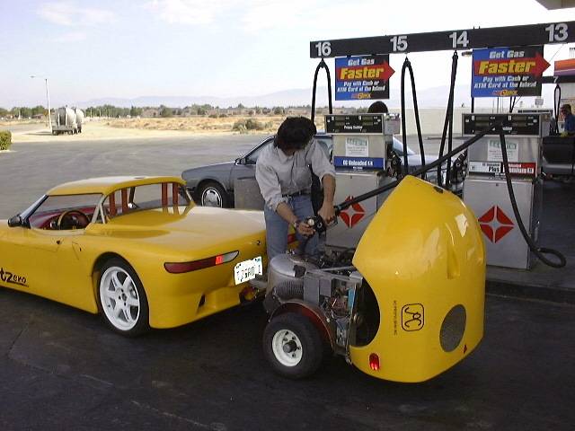

So I was reading about Tesla's plan for battery swapping. I didn't think that was such a great idea, since you would be leaving behind something that was a good fraction of the cost of the car. Might there be a better way?:
So, it's the future: You've been driving around town, and used up half your cheap car's 90 mile range. (Not a Tesla, obviously.) Suddenly there is a big crisis-or-opportunity, and you need to jump on the highway and get somewhere 200 miles away as fast as possible! There is no need to go home first, (which is the wrong way anyway.) So what can you do?
Answer: You drive to the nearest rental place and have them latch a gas trailer to the back of your car. This device would be a gas generator plus tank, and would charge your battery while you are driving. (I assume, it would need to generate power faster than your car can consume it at highway speeds.) It effectively turns your car into a hybrid. But the advantage is that the car would cost less, and you wouldn't need to carry the weight of the engine and tank around except on the days you'd need them. (Maybe 3 days a year for most people?)
So my question is: How big would such a generator need to be? Could it attach to a hitch like a carrier rack? Or would it need it's own wheels like a trailer? (I'm assuming that the latter would make the car more difficult to drive.) I suppose the government would have to mandate a standard plug for power and brake lights. How difficult would that be?
Okay, if this has always been around, then why was everyone freaking about range anxiety?
I'm not sure who's freaking out but a trailer is probably not a viable solution for most people, storage, cost and convenience are concerns, which is likely why genset trailers have remained a niche product. In my country, trailers require ongoing costs for registration and safety testing (like other vehicles) so owning a trailer for just a few days use a year is not appealing. Maybe people who want an LEV and are concerned about range buy a hybrid? Many can be run in electric mode only can't they?

This isn't practical.
  1. They cost $15,000 and up.
  2. Many EVs have interlocks so you can't drive while charging. This has the side effect of prohibiting charging while driving. So you need to drive, stop, charge, drive, stop, charge, etc.
  3. Many EVs do not tow.
Ignoring #2 and #3, #1 is a killer. If you say "but someone can just rent one", for less than the cost of the rental (probably much less), one could rent an entire car. Isn't that simpler?
Billy: The idea only makes sense as a rental. If you need this more than a few days a year, you should buy a hybrid instead.
Vanadium: That cost is certainly because those are hand-made one offs, not mass marketed. Stationary gas generators can be had for $400, and ARE light enough to go on a hitch, so adding the mobility can't be that expensive. Of course you DO need to design the car to accept the generator, but current hybrids can charge and drive at once.
Another way to look at my proposal is to imagine a hybrid and make the generator and tank detachable, and rented. So I know in terms of hardware this stuff exists.

Sustained. From Billy's link, you need 20-25 kW, which will run around $5,000.
Towing a trailer costs quite a lot of energy so you wouldn't want to do it all the time. You would need some enterprising company to make them available to hire and it would probably be one way hire. I can't see any company investing in the infrastructure for this as it will be rendered unnecessary in a few years.

Just for info... Back in 2000 I attended the F5B model flying world championships in San Diego. This is an event for electric powered modl aircraft. An electric sports car turned up with just this sort of generator/trailer in tow. They had driven hundreds of miles to get it there. I think the car might have been a converted Lotus? It was bright yellow and the trailer was a matching colour. I've been trying to find a photo online but no luck so far.
Was it an AC Propulsion Tzero? It is actually the inspiration for Tesla Motors.
Likes RonL
Yes that's the beast.
