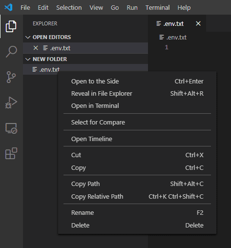

I am having an error setting up mern
https://www.digitalocean.com/community/tutorials/getting-started-with-the-mern-stack#testing-api
I have to assume I didn't follow the instruction properly.The error is under Database section from the link above. When I type
Code:
require('dotenv').config()
into the terminal. The error I get is
Code:
Method invocation failed because [System.String] does not contain a method named 'config'.
At line:1 char:1
+ require('dotenv').config()
+ CategoryInfo : InvalidOperation: (:) [], RuntimeException
+ FullyQualifiedErrorId : MethodNotFound
My directories look like this
Inside models is todo.js and inside routes is api.js.
Do you think inside .env I have the wrong password? Also in visual studio advance when I save .env it comes back as .env.txt

It does look as though your .env file is actually called .env.txt - you can see this from the file description in File Explorer - you should have 'hide extensions for known file types' turned off by default in File Explorer and then it would be clearer.
Are you in Visual Studio or Visual Studio Code? For node I can't see much advantage in using VS, I just use VS Code. It could be that there is some VS "magic" going on that is adding the .txt extension, I have never had this problem in VS Code.
Likes DaveC426913 and sysprog
I am in Visual Studio Code. The .txt extension was automatic upon saving the file.
If the first field in a file name begins with a period mark, as .env does, it won't be treated as an extension, and a default extension will be appended to it; you should rename the file.
I tried naming the file .env .I am sorry if I am not following.
Try renaming it to something.env, where 'something' is the right name for whatever the file is defining environment conditions for.
I found a problem when I save the file it is saving it as plaintext, where the save as type column is. I fixed the problem by saving it to all files. Was that what you were trying to say? Also when I add something.env the terminal still gets the same error. I also tried just .env and get the same error. Also index.js etc is saved as a javascript file is that correct file type. The exact name of index.js is index inside the directory stored in the computer
Please understand what @pbuk said about turning off 'Hide extensions for known file types'.
In Windows Explorer, from any folder: Tools > Folder options > View > unclick 'Hide extensions for known file types'. Then click the 'Apply to Folders' button at the upper left. Then click 'OK' at the bottom left center.
You should then be able to see full filenames. That should make things clearer. I'm glad that you were able to find a workaround.

No, the file needs to be called .env - it uses the POSIX convention where files and folders that start with a period (often referred to as dotfiles) are used for configuration and are normally hidden from the user.
This whole notion of tight coupling between extensions and file 'types' is a Windows thing. Node is a cross-platform environment, and VS Code is a cross-platform tool so it uses the OS's 'save file' dialog. This is not helpful, as you have found.

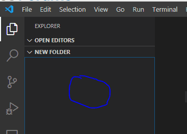

You have found a solution already, but I'll show you the way I do it. This has the advantage of bypassing the system dialog altogether so works consistently across Windows and Linux and any other platform VS Code runs in.
Instead of creating a file in VS Code using the menu, right-click in the file panel in VS Code (where the blue circle is below) and this will bring up a dialog with a 'New File' option which doesn't have the Microsoft extension nonsense.
Alternatively, rename the file after creating it by right-clicking on the file in the directory pane to bring up the dialog below.
