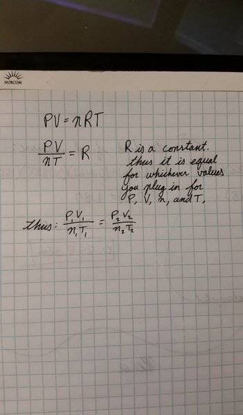

here's how my equation came up to be. this is how i learned it.

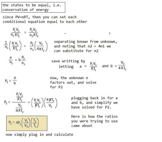

Here is how I derived the equation to solve for final pressure. This show's you where your idea of multiplying by ratios could work if done properly. You don't need to calculate the moles in the beginning, then multiply by 4, then stick new number in...the moles cancel out as you'll see...
plug ur numbers in and see if this gives you the right solution; and remember to watch your units
