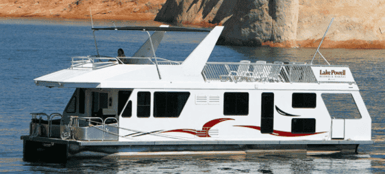

Improving Air Flow on a 50ft Houseboat in the Desert SW
In summary: Maybe insulation on the outside walls and roof? Adding insulation to the outside walls and roof is a great idea!
Specialblend21
Ideas on moving hot air from houseboat to enhance natural flow with additional solar 12v fans. 50 foot pontoon houseboat mobile home style cabin in desert southwest. Boat has windows but takes hours to cool down in evening when outside temp is cooler. working to isolate why cabin stores so much heat even with windows open and outside breeze and want to learn more on positive negative airflow, hot cold transfer. Working to not cut additional holes in roof if possible.
Ideas are:
  • Push air our with 12v fans place high on side walls.
  • Pull air in from under boat in shady dry area between pontoons.
  • add small 12v powered swam cooler
  • more venting
Any thoughts appreciated.

The OP didn't tell us much about his houseboat, but the photo shows the kinds typical on Lake Powell.
Fishermen report that the thermocline in Lake Powell is at about 20 feet. Below the thermocline, you can find cooler water. The water is fairly clear. The next photo shows a striper at 25 feet.

The best way to arrange for more shade on a boat is to move the boat, not to hang out awnings.
