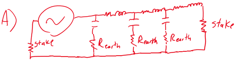

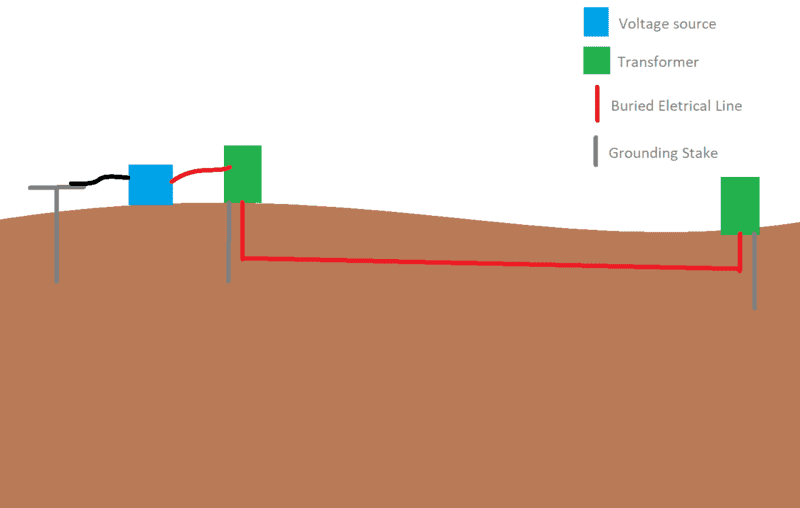

I work for a company that locates underground cables and pipes. We apply an AC signal to the underground facility and to be able to detect the location.
Take the simplified drawing above. Two transformers grounded with a buried electrical cable. We use a transmitter and connect it to one transformer. There's clearly a current divider here - some of the current will go out the transformer ground and some will carry on the metal sheath of the electrical cable to the far transformer.
I have an argument with some of my colleagues about the concept of ground path return. They say the electrical signal must return to the transmitter ground to complete the circuit. To me that is modelling the Earth as a resistor. That would certainly be true if we used a DC signal.
But we use an AC signal, typically 8 - 30 kHz, but sometimes as low as 500 Hz. I argue the Earth is better modeled as a capacitor, and the signal does not necessarily travel back to the ground stake.
What say you?

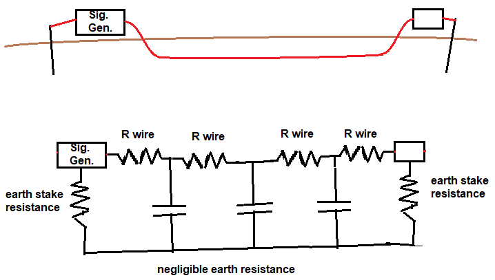

However you look at the earth, your generator produces a signal that drives antiphase currents of equal magnitude out of its two terminals. So it seems odd to me to say the signal doesn't come back to the ground terminal. I might even say, the signal goes out from both terminals simultaneously and maybe never comes back.
Now, whether you model the circuit between the output terminals as a capacitor or a resistor, is another question.
A good Earth connection at both ends should appear as a low resistance between the output terminals. My understanding is that all the significant resistance is in and around the Earth connection. Beyond that there are so many parallel routes that, however resistive, the net resistance is effectively zero. (I see this as analagous to the field of a solenoid only being significant inside and near to the ends. Beyond that the field is spread over such a large area, that the flux density is effectively zero.)
So I would be inclined to model your cable like this:
where the wire resistors and parallel capacitors are many, expressed by the resistance and capacitance per unit length of the cable.
PS. I see Anorlunda has replied showing the series inductance, which I'd forgotten about.

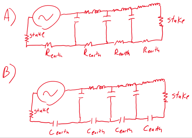

So question I think is whether A) or B) is more correct.
I think as F increases, Rearth decreases, and Cearth increases - the models converge.
My interpretation is model B - there is no return through the ground. The Earth is simply absorbing and supplying charge like a capacitor.

Those schematics are misleading without putting numbers on the components.
The underground conductor is very close to the ground; say one inch. Those are the capacitors I showed in my diagram.
The return path, which you show as Rearth or Cearth represent long distances, perhaps miles. So the impedance is very high.
mcstatz5829 said:
there is no little return through the ground. The Earth is simply absorbing and supplying charge like a capacitor.
I endorse that. That makes the sketches A and B unnecessary.

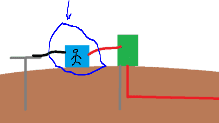

By "signal" do you mean current ?
Seems to me Kirchoff dictates that current must get back to whence it came.
Put yourself inside the signal generator.
Any charge exiting to the right must be replaced by one entering from the left...
irrespective of what it flows through to get theredid i misunderstand the question ?
I think this is one of those rare exceptions where we can't use KCL or KVL. It is not a closed circuit. In order for this application to work, there must be energy (in the form of a tone) leaked from the cable to an above-ground detector along the whole run.
We are using the Earth as a source/sink for small charges for a short time. The only analogy I can think of is a Van de Graff generator where we (unidirectionally) pump charge to the dead end of an open circuit.

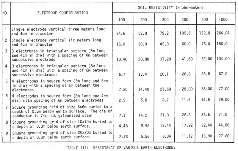

The best description of this I've found so far is a leaflet by Fluke. There it is suggested that effective ground connections should be less than 25 Ω (NEC 250.56) or less than 5 Ω (NFPA and IEEE). This appears at odds with the typical values they give for grounding stakes in different soil types (which are in line with your 1 kΩm resistivity), except that they point out, a ground connection can be realized by an array of spaced ground stakes, plates or burried mesh, which can reduce the resistance by upto 40% for doubling the number of stakes. (I guess the 40% is a sort of cost benefit optimum, since to achieve 50% would require no interaction so very large spacing.)
So in good soil (<300 Ωm) a 16 stake array should meet the <5 Ω criterion. Dry sandy soil at 1000 Ωm might need over 100 stake array, or whatever the equivalent mesh or plates array is.) . Increasing the size depth of the conductors also helps.

This seems to give an Earth resistance of 0.05 Ω/km not including the electrode resistance at the ends, for which he gives these examples:
So this does not support my notion that the Earth has effectively zero resistance, but it does mean the Earth return resistance is dominated by the electrode resistance upto ~100 km. I can't find the Rudenberg info, obviously not as memorable as his electron microscope work, so I wonder if that, presumably approximate, formula is intended to be valid over larger distances?
