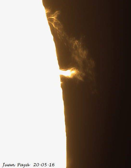

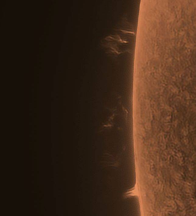

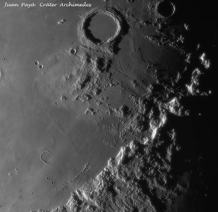

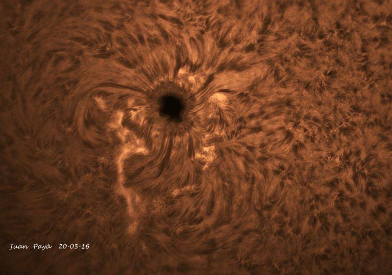

sophiecentaur said:
I wonder about the sensitivity of that camera though.
Some examples from the mono version of the ZWO 120mm
I had 2 more but the flamin forum is refusing to upload them
really getting frustrated with this :frown: :frown: :frown:
  • Wow
Likes sophiecentaur
OK try again
The solar images are with a 60mm Coronado solar scope
The lunar shot is with a Meade LX200 scope
Juan is from SE Spain, his solar imaging is truly outstanding. You should see some of his images
they look almost 3D. He puts a lot of work into those style doing video clips and staking in Registax
and some other processing

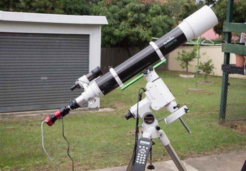

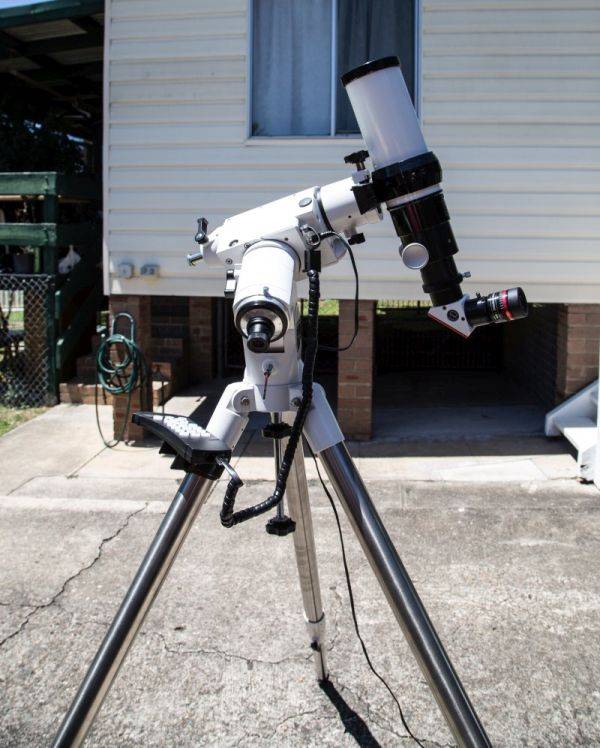

my toys ...
The one mostly used the LUNT LS60THa on a HEQ5 PRO mount
and the occasionally used system
A DAYSTAR Chromo Ha system on a Skywatcher ED120mm and the HEQ5 PRO mount
Dave
How do you rate the Daystar against the Lunt?
Likes davenn
Two very different ways of getting same/similar results
LUNT ( which ever model/size), very easy to use. An all in one system
Daystar, 2 models available, the prominence filter and the chromospheric filter
I bought the chromo. one as the bandwidth of my LUNT is a little broader ( 0.7A +- 0.2 A (approx)
That is more suitable from prominence viewing.
The Daystar Chromo. is approx 0.25 - 0.5 A centred on approx 0.4 A. This is better for viewing
surface features.
My Daystar Chromo Quark unit as you see above on the 120mm refractor also can be ordered
with adaptors to suit Canon or Nikon cameras and lenses ( Canon for me).
I have to admit that my LUNT gets much more use than the Daystar, mainly because of the ease of use.
All the photos in my main pinned solar observing thread, that I linked to earlier, have been done
with the LUNTcheers
