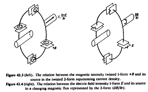

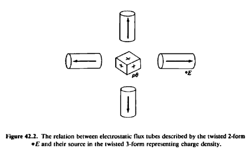

Here's are 3 of Maxwell's Equations as spatial [twisted-] differential forms from Burke's Applied Differential Geometry
Likes vanhees71

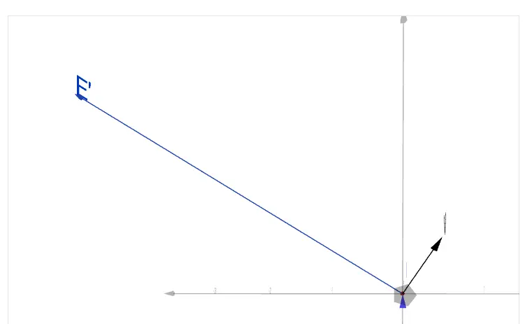

I've added the option to show component-vectors parallel and perpendicular to the boost-velocity, and also the option to show Poynting vectors.
Oh, and fixed a bug that nobody seems to have noticed (or at least mentioned): I had a sign-error that was causing boosts in the negative x-direction to give exactly the same results as boosts in the positive x-direction.
It was actually a little tricky to figure out whether this was indeed a bug. Since I've never seen a similar visualization, my intuition wasn't quite there. What convinced me was configuring E = [0, 1, 0] and B = [0, 0, 1], which is like a light-wave moving in the positive x-direction, and reasoning that the fields should shrink when boosting "with" the wave and grow when boosting "against" it (they were shrinking both ways before).
