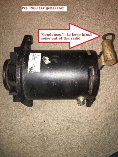

Sparking at the brushes makes radio waves emanate from the sparks there
likewise the rapidly changing current in the wires feeding your motor radiates EM waves just as in any antenna
Place a capacitor across your wires as close as possible to the brushes . That'll reduce radiation from your wires by short circuiting the antenna wires..
Might be enough to do the job - interesting experiment...
When car radios were invented in 1920's the engineers had to handle brush sparking.
