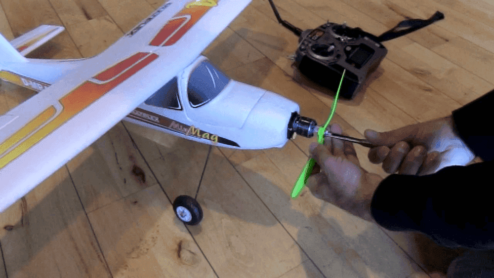

https://i.ytimg.com/vi/uOHckOudGGQ/maxresdefault.jpg

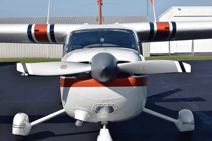

https://hartzellprop.com/wp-content/uploads/Voyager-Propeller.jpg
Versus:
https://hartzellprop.com/wp-content/uploads/Cessna-177B.jpg
