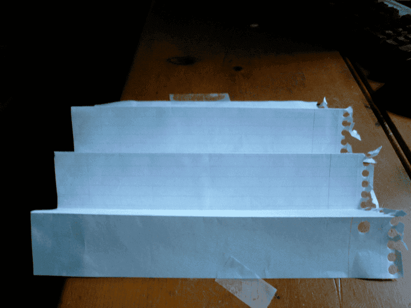

Hi all, First time post, long time lurker, sorry if this is in the wrong section.
I am currently looking at a project that requires a large solar panel array onto a very tight roof area; maximising space is therefore important. Thus, keeping the panels as close together is important.
I have a found a calculation methodology that requires the solar altitude angle and solar azimuth angle during the earliest time on the winter solstice (worst case scenario) and then requires the following:
Dm = h/tan(a) Where Dm = Maximum Shadow length, h=height of panel, a = angle of orientation.
D= Dm * cos (180 - u). Where D = Min Spacing between panels, u = worst case azimuth on winter solstice.
However, this method is for due south azimuths only. Therefore, has anyone got any suggestions as to how to accurately calculate the minimum distance between panels. I assume, that I would take away the difference between the actual orientation of the panels and south azimuth away from (180-u), but my trig skills are not up to scratch and would like some help on this one.
Thanks so much in advance,
Charlie

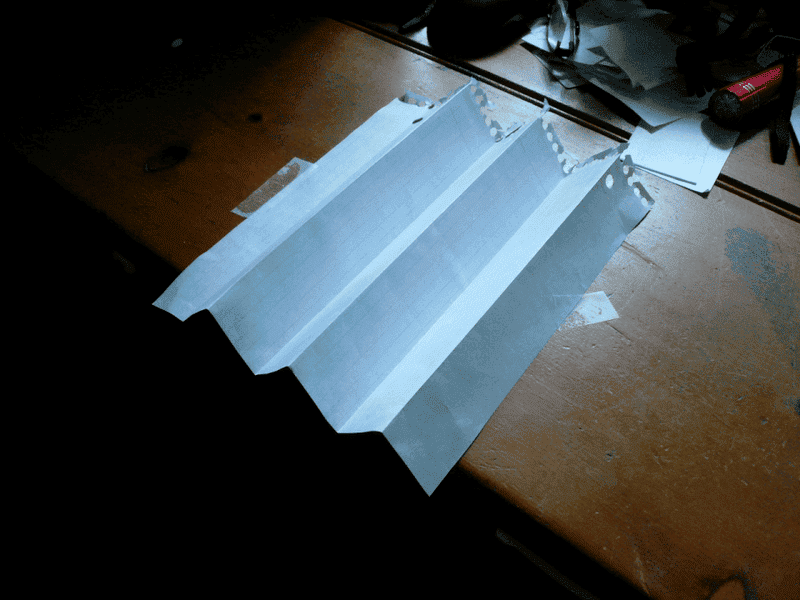

Interesting problem, thought about it, wheels spinning, made a model of an array out of folded paper, now less confusing. Fold a piece of paper as below and lay it on a table. Let it represent your array. Pretend you are the sun. Move about as if you, the sun, were moving about the array. Now Imagine rotating the array so it does not face due south and continue to imagine you are the sun illuminating the array. With this done maybe the math will be more obvious?
If the array aligns due south, then with the proper spacing on the shortest day of the year the entire roof will be shaded by the array and every inch of the array will be illuminated by the sun all day. If the array does not align due south then it will be a compromise between panels being shaded and roof not being shaded?
This seems to be a complicated optimization problem for alignments not due south. Panels are relatively expensive, you don't want them to shade each other except for a small amount near the end of the day when not using a due south alignment?
