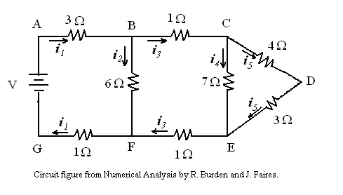

It occurred to me that a simple homework problem could emphasise the point. Take any problem where students are asked to solve for voltages and currents. Then ask for it to be repeated shifting the ground symbol to several different points in the circuit. Students should quickly grasp the point that it makes no difference where the ground reference is.
Likes cnh1995 and Dale

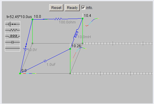

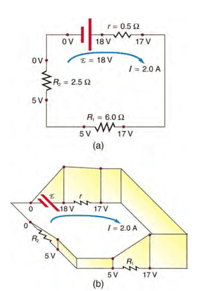

I like the "voltage as height" rendering of schematic diagrams (see below).
Then it's more clear that it's differences in potential [voltages] that are important.
From OpenStax College's "College Physics" (Urone)
https://openstax.org/details/books/college-physics
or, implemented dynamically at
http://www.phy.ntnu.edu.tw/ntnujava/index.php?topic=30.0
