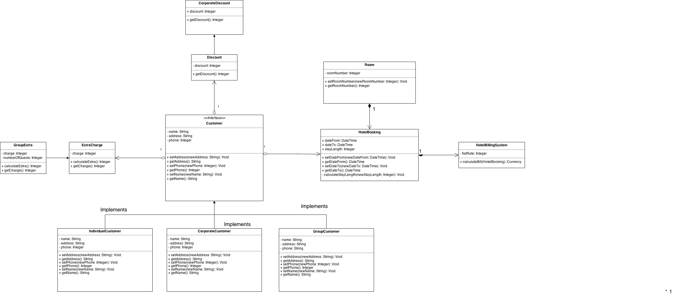

JaAnTr said:
Ok, I've got the first line giving me no errors but the second one still is:
Code:
	        Customer customer = booking.getCustomer();
	        Discount discount = customer.getDiscount();
I can see on my UML diagram that the Discount class is connected to the Customer class by aggregation. So does this mean that the Discount class needs a Customer passed to it in it's constructor and then a getDiscount method or is it the other way around? Because the Discount class is just an interface that looks like this and I know interfaces can't have constructors so how do I connect it to the customer?
Code:
import java.math.BigDecimal;
import java.util.Calendar;
import java.util.Date;public interface Discount {
	public BigDecimal getDiscount(Date date);
You are right that the Discount is an interface. However, the classes derived from Discount (such as CorporateDiscount) are not, so these are the ones you attach to the Customer. If the customer has no discount, then it just stays null, otherwise [say, in the CorporateCustomer's constructor] you can create a CorporateDiscount and assign it to that customer's discount field (so that getDiscount() returns that).
(you can assign a CorporateDiscount to a Discount because a CorporateDiscount "is" a Discount, i.e. it inherits from it - this is what allows polymorphism)
I'm slightly confused what, for example, the CorporateDiscount class should look like then? I've added a constructor that takes a customer but don't know what you mean when you say "create a CorporateDiscount and assign it to that customer's discount field (so that getDiscount() returns that)."

Something like this (EDITED):
Code:
public class CorporateCustomer implements Customer {
    private CorporateDiscount discount;
    public CorporateCustomer(String name, String address, etc..) {
        discount = new CorporateDiscount();
        this.name = name;
        // etc..
    public Discount getDiscount() {
        return discount;
    // etc..
And then the CorporateDiscount has no knowledge of the customer class and takes no customer in its constructor (it's the opposite: the customer knows about the type of discount it is entitled to).

But I'm still getting an error on this line in HotelBooking:
Code:
With the error "The method getDiscount() is undefined for the type Customer".
  • #40
You probably haven't added the getDiscount() method to the Customer interface.
  • #41

		GroupCustomer myGroupCustomer = new GroupCustomer("Jane", 01633, "24 Western Avenue", 10);
		HotelBooking hb3 = new HotelBooking("2015 02 22", "2015 02 28", myGroupCustomer);
		hbs.calculateBill(hb3);
		List<Customer> customer = new ArrayList<Customer>();
		customer.add(myCorporateCustomer);
		customer.add(myIndividualCustomer);
		customer.add(myGroupCustomer);
As you can see at the bottom I've added the 3 customers that I have created to an ArrayList which holds customers. What is the advantage/point of doing this?
Cheers :D
  • #47
The main advantage is that you can loop over it to get the hotel billing system to calculate the bill for each customer automatically, I think. For instance you might load them into a list from a database and need to be able to operate your billing system no matter how many customers there are, in the real world you won't just have three customers hardcoded into your main function ;)
Of course with your design it probably makes more sense to put hotel bookings in a list instead, since that's what the hotel billing system operates on - so you might have a list of customers in the system (or a map from customer name to Customer class, for convenience) and then a list of hotel bookings that reference the customers from that list [as a parameter to their constructor] and finally the hotel booking system iterates over that list of hotel bookings and generates bills for each. Right?
  • #48
Oh ok that makes sense. Just one quick question, I'm curious as to why the Customer class that I've used is an interface as opposed to an abstract class? Seeing as there are some methods which some customer classes essentially don't use, like IndividualCustomer returning null for discount and extra charge. If this was an abstract class then am I right in saying those methods would just not need to be implemented at all?
  • #49
You are absolutely right that Customer would be better suited to be an abstract class than an interface, the reason being that all Customer derived classes have exactly the same functionality and only differ in the data they contain (the discounts, charges and name/address/etc). This is made obvious by the fact that the only difference between the different types of customers is their constructor.
989
