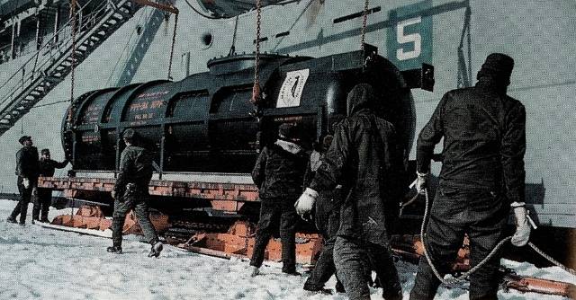

Fuel ponds aren't that energy dense and the primary goal is to keep them cool, not produce power.
PM-3A created 9.36 MWt in a pressure vessel this large:
