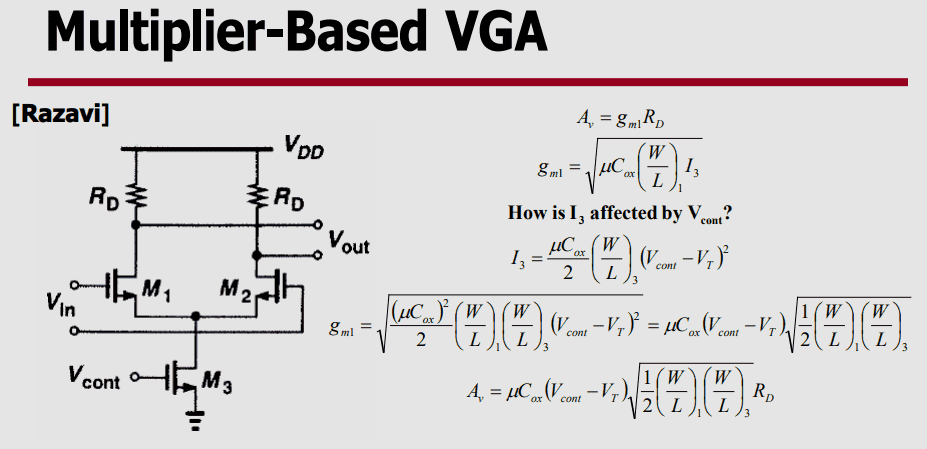

Find the gain for this VGA
I(sat) = k(V_gs - V_t)^2
M1 = M2 = M3
I need to find A_v, I want to relate Vin to Vout. To do this I did KVL on the major loop:
$$V_{DD} = I_D*R_D + V_{SD1} - V_{SD2} - I_D*R_D$$
Since M1 = M2 then everything would cancel out and I would just get V_dd = 0 which is probably wrong. This is assuming V_sd1 = V_sd2, is that correct?
Sorry, your post is very disjointed to me. Vdd is a power supply voltage that has little directly to do with the voltage gain ##\frac{V_O}{V_I}## of this circuit.
And the jumble of equations that you have posted to right of the circuit make little sense, especially since you have not defined terms like ##I_3## etc.
Try again?

Sorry, those equations to the right are what the author already solved. I am trying to find out how he got the gain of ##g_{m1}R_D##. Vdd is in my equation because I thought I could use KVL to solve for Vout/Vin but from your feedback I can tell that I am wrong. How would you find the gain?
What is the traditional voltage gain for a common-emitter or common source transistor amplifier? Why?
Likes Joshy
It looks like you are assuming that the drain currents are the same in M1 & M2. In that case you are correct, everything cancels and the output is 0 (not the gain!). Maybe consider KCL too? Also, notice that the gate voltages may be different.
Start over but next time be more careful about naming each current and voltage. Just because they may (or may not) have the same value, that doesn't mean that the currents, or voltages, are the same. Cancel terms after you have made the equations, not while you are constructing them.

Anyhow: To approach Berkeman's question I would draw a common source amplifier and replace the MOSFET with its small signal model. What happens to the DC supply (##V_{DD}##)? Solve for its ##v_o/v_i## and you'll mysteriously stumble upon solutions Razavi is sharing on the right side. I think once you try that out for yourself that'll really help clear things up.
DaveE is totally right about the gates not being the same voltage: The two gates aren't the same voltage. You can see right in your picture one of them is ##V_{in}^+## and the other one is ##V_{in}^-##. I wouldn't get too twisted over noticing that right now, but just to clear up the air further about things possibly "canceling out" when it's not.

I am familiar with the pi model for the mosfet but thought that would be overdoing it since the mosfets are equivalent and thus I would be able to cancel out terms using KVL. I see now that the gate voltages are different. Ill try it again.
Yes, use the simplest models first. Then, IF NECESSARY, make your models more complex. I would start with a voltage controlled current source model first, since it's the simplest thing I can think of.

Following your advice and using the small signal model I come up with the following:
$$V_{in} = V_{GS1} - V_{GS2}$$
$$V_{GS1}gm_1 = I_1$$
$$V_{GS2}gm_2 = I_2$$
$$I_1 = -I_2$$
$$gm_1V_{GS1} = -gm_2V{GS2}$$
Rearranging the second and third equation and subbing to one gives me:
$$V_{in} = \frac{I_1}{gm_1}- \frac{I_2}{gm_2}$$
and using equation 4:
$$V_{in} = \frac{I_1}{gm_1}- \frac{-I_1}{gm_2}$$
Can I assume gm1 = gm2 since they are the same op amp?
If so then I would get:
$$V_{in} = 2 \frac{I_1}{gm_1}$$
and using the fact that ##I_1 = I_{D1}## and ##I_{D1} = \frac{V_{DD} - V_{out}}{R_D1}## then:
$$V_{in} = \frac{2*(V_{DD} - V_{out})}{gm*R_{D1}}$$
And here I do not know where to go.
I meant just one common source amplifier. Try that one out :)

Oh ok I had forgotten that in small signal analysis I had to shut off all DC sources. Now I get the equations I need. If I was not doing small signal analysis then I could take the derivative of the Vout/Vin to get the gain?

I think, the circuit cannot work because you have applied Vin BETWEEN both gates - without any ground difference. Both gates should get its own input signal (Vin1 resp. Vin2). Both can be equal or opposite or assume arbritrary values.
Sorry...instead of "difference" please read "reference".
