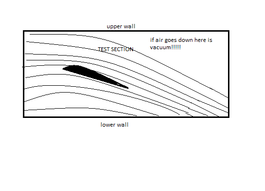

Wall to wall airfoil has "wingspan" same as wind tunnel width, high pressure can't leak to low pressure at tips.No wingtip vortices.
In wall to wall airfoil in closed test section downward movement of air will create a void above it(walls/vacuum stop this action), and the air below has to make place for that downward moving air,but again walls stop this action.
How then this is possible in fully closed wind tunnel even test section is very big/tall compare to airfoil?
Upper(ceiling) and lower(floor) walls don't allow that air circulation which downwash requier.
In wall to wall airfoil in closed test section downward movement of air will create a void above it(walls/vacuum stop this action), and the air below has to make place for that downward moving air,but again walls stop this action. How then this is possible in fully closed wind tunnel even test section is very big/tall compare to airfoil?
Upper(ceiling) and lower(floor) walls don't allow that air circulation which downwash requires.
A fresh stream of air is flowing into the wind tunnel. For a tall wind tunnel, in order for a pressure differential to be created, part of that air flow has to be diverted downwards, it will eventually recover, but there will be downwash in the vicinity of the wing.
