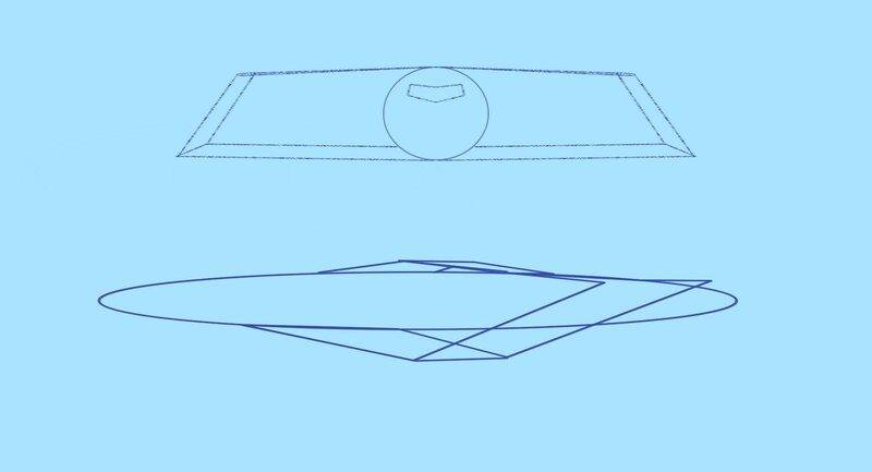

Well you caught me I didn't watch the video. I was just using the thumbnail as a visual reference. I've seen other model aircraft of the same design that seemed to have better performance but I'm not sure I can find it now. As to your questions I'll try to answer them as succinctly as possible below.
1. Problems
- wing tip vortices reduce efficiency, no wingtip, no wingtip vortices
2. Better.
- rings are stronger than lines, less strength needed lighter less dense materials, greater load capacity
- entrainment does not provide lift but airflow over surfaces does, less energy to move air over surfaces more efficient lift per unit of wing area.
- the sides of the ring can have control surfaces that replicate upright functionality of tail section, the offset of wings from perpendicular replicates the functionality of lateral function of the tail section (lift available at different points along the fuselage. (pics and description below. This potentially eliminates the need for a tail entirely saving weight, drag and failure points.
I can see how the video above would not inspire much confidence having said all this so let's imagine the following:
1. wing rigidity similar to modern airlines.
2. fuselage centered within the ring.
3. ring squashed into an oval with shorter radius perpendicular to the ground so fuselage is connected to inner surface ring at two points opposite one another.
4. Rotate ring by 45 degrees along it's profile so that the rings connections with the fuselage are now at the following points from the tip to the tail at the first 1/4 length below and above the last 3/4 above. This means the ring/wing is swept back.
I would also add perhaps theirs also a version greatly scaled up which could eliminate entirely the tube and en-corporate cargo capacity into the wing itself (imagine two flying wings connected at their tips)
I've included a crude sketch to help for those less imaginitively inclined. Also in case it's not patently obvious, I'm no engineer so you patience with my crude understanding and obvious oversights is greatly appreciated.
edited for clarity

But then, you run into the new problem of the top surface interfering with the airflow over the lower wing, reducing its lift efficiency.
Note how biplanes where replaced with single wings when the resistance to bending of the light materials was increased with time.
What about a swept back design? Apologies for the crude sketch? Also see another post with attached pic for more detailed description.

You make some broad claims that I doubt.
1) "greater lift profile for a smaller radius of wing": Not sure about this because so much of a ring does not have a normal pointing upward. It seems that the more upward force you want, the more you will flatten the ring into an oval. Then you approach a biplane and @Lnewqban's comments in posts #4 and #6 apply.
2) "rings are stronger than lines": stronger against which forces? Certainly, the sides of a ring tend to bend out and are weaker against those forces.
