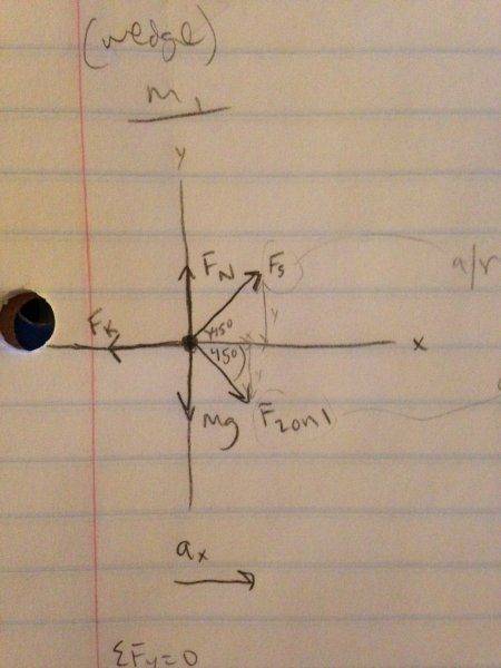

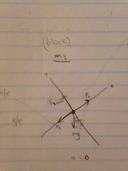

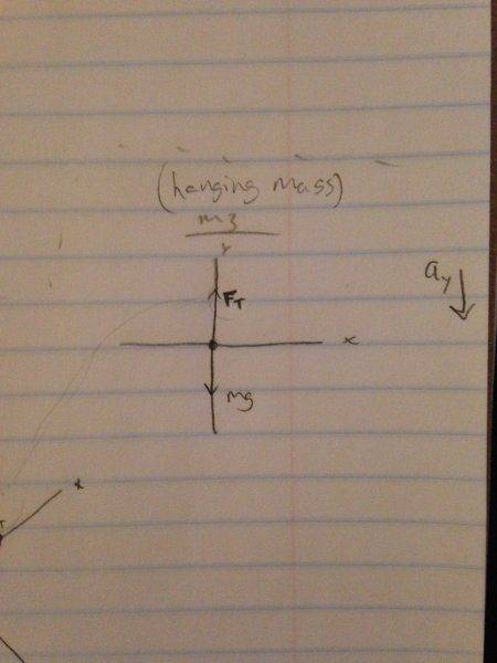

Well, first I made the force diagrams and noted the action/reaction pairs. I'll put them on so you can see if I did those right or not. Then, I figured the net force in the y-direction for the 2 kg block had to be equal to 0, so I solved for the Force of block one on block two (F1on2). Then, I figured that the net force in the x-direction for the 2 kg block had to be 0 (I rotated the coordinate axes for that block) in order for it not to move, so using the F1on2 I just found, I found the static friction on that block by multiplying it by the coeff. of static friction given in the problem, and solved through for the tension in that block, then used that as the tension in the hanging mass as well because they both have tension forces coming from the same rope, and I set that equal to the "mg" force in the hanging mass and solved for m and got 2.3 kg. I guess that seems like a reasonable answer, but I feel like it couldn't have been that simple, there's so many other aspects to this problem.

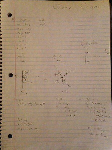

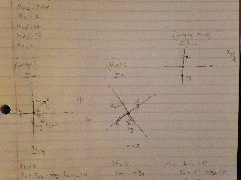

here's my full page of work so far.

I can't really work out from your notes what exactly youi've done, but 2.3 kg is too much. Here's why:
Unless the 2 kg block starts to slip, then effectively it's stuck to the 1 kg block and the internal forces (between the blocks) must be equal and opposite. So, you consider them as a single block.
The maxiumum friction force of the two blocks and the ground is 3g*0.2 = 0.6g. That's all it will take to move them. So, a rough guess at the answer is about 1 kg.
The key is to work out the minimum and maximum masses for which the 2kg block does not slip. Then, within that range, you can look at the external forces.

I'm going offline, but here are a few ideas:
First, note that on their own, the 2kg block will slide down the incline. So, there's a minimum mass needed to stop that. I'd calculate that first to get a feel for the problem. The answer is ##0.4 \sqrt{2} \ kg## See if you can get that.
Second, find the mass needed to make the 2kg block slide up the slope. The answer is ##1.6 \sqrt{2} \ kg## See if you can get that.
It's not really necessary to calculate these two masses, although it confirms the problem makes sense and helps validate the answer.
What I'm saying is that between these two masses, the blocks don't slide, so you can look at the external forces only.
So, you can try solving the problem using only external forces. And hope the answer comes out between the two above!
PS I guess that ##1.6 \sqrt{2} = 2.3## is the answer you got! That's what's needed to pull the block up the slope.
Ok I finally solved for the hanging mass needed to keep the 2 kg block from not moving, but I got .56 kg. Then I used that to find the net force in the x-direction for the whole system and got -1.2 N. So I'm thinking something went wrong somewhere lol. Basically, I don't know what to do after finding that minimum mass. I just plugged it into a bunch of stuff to see what I could come up with anywhere but it led me to a negative net force in the x-direction for the system somehow, so something somewhere is not right.

Yes, that's right. At 2.3 kg, the 2kg block will start to slide up the slope.
The 0.56 kg is correct (that's ##0.4 \sqrt{2}##).
To solve the actual problem, you have two main external forces: gravity and tension from the block. You need to calculate the nett force on the block: you need to express this force in horizontal and vertical components.
Then, you can calculate the friction with the surface and work out at what point the blocks start to move.
