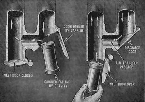

I'm still not sure, but it sounds like the OP wants to do drop tests with small plastic enclosures in some drop channel. Kind of like the old pneumatic tube transfer system, but in a non-pressurized drop instead of pressurized tube transfers... ?
http://www.douglas-self.com/MUSEUM/COMMS/pneumess/pneu2b.jpg
