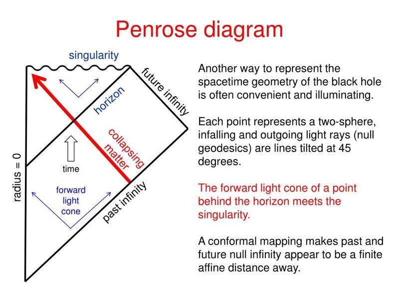

What I had in mind was not the maximal extension, but only this:
Ok. But the OP is asking about the maximal extension.
