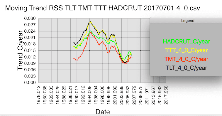

I am in a discussion with someone concerning AGW, and he likes to use "the last two decades!" to prove there is no AGW or AGW is in the "noise". I generated a 20 year moving trend plot for HADCRUT (surface) and three troposphere (satellite) data sets. I think this clearly shows the strong similarities between the data sets. (The center of the moving trend is the plot point)

First, I would not be at all concerned with the absolute values because that is due to how the baseline is calculated. For example, Figure 2 appears to use the peak of the elNino effect as the baseline. Also, separating the data sets can make the chart more readable. Having said that, the trend (slope of the line) is what is important.
The second point is, because of the relatively large variations in the data, it is good to have a lot of data points when determining a trend. Climate scientists like to have 30 or more years of data before declaring a trend. Figure 1 has 18 years of data, and the trend has a lot of uncertainty associated with it. A larger database, 30 years in Figure 2) reduces the uncertainty in the trend and increases the confidence in the trend value. As a result, the trends are more similar between satellite and ground meaning both are tracking each other.
I did the fancy moving trend analysis using 20 years (political reasons) because I thought it would more clearly show the tracking and similarities.
Finally, MSU/RSS very recently updated the TLT corrections and further reduced the differences.
I hope this answers your question.
