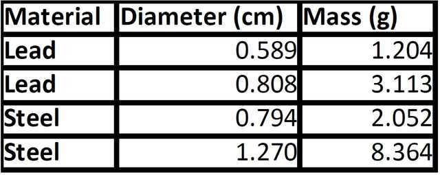

Table 1:  Diameter and mass for four spheres used in the experiment.  All digits may not be significant but are included to reduce rounding errors in anticipated predictive modeling.
Method
Four different spheres of known diameters and masses, as described in Table 1, were individually suspended using forceps near the top of a graduated cylinder containing canola oil and glycerol, then dropped to go through both fluids before reaching the bottom of the cylinder.   Liquid thicknesses were a compromise between fitting into the height of an available graduated cylinder and having smaller spheres approach terminal velocity in each liquid.  The graduated cylinder and liquids are shown in Figure 1.  Pilot testing has shown that when released from the air, an air bubble attaches to and remains with the sphere for 5-10 cm into the liquid which significantly impacts the net force and dynamics of the sphere falling through the fluid.  Releasing the sphere from a position slightly immersed in the top liquid eliminates this confounding factor and ensures more accurate data.

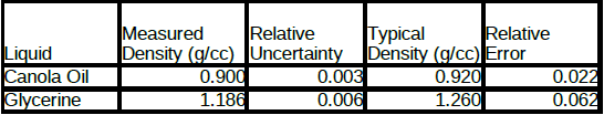

Predictive models require accurate fluid densities to accurately compute the buoyant forces on the falling spheres.  For the temperature at which the experiment occurred (28 °C), the densities of canola oil and glycerol were experimentally determined by measuring the mass of each fluid at 10 equal increments in a graduated cylinder on a calibrated digital scale and performing a linear least squares fit to determine density as the slope of the best-fit line of mass vs. volume.  With distilled water, this technique has been shown to give agreement with accepted values to within 0.1%, which is the uncertainty in the slope measuring with distilled water.  Uncertainties with canola oil and glycerine are larger, likely due to the higher viscosities of these liquids.  However, the differences between the measured densities reported here in Table 2 and typical values are significant, likely due to variations in the production and purity of these consumer products. Given these variations, it is recommended that any modeling use measured densities from the experiment in question rather than typical values.
liquids tested table of data
Table 2: Densities of canola oil and glycerine needed for predictive modeling.  The relative uncertainty is computed from the reported uncertainty in the best-fit slope.  The relative error is computed from the difference between typical reported densities and the measured density reported here.
