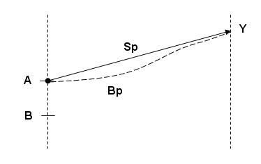

The diagram below represents the double slit experiment.
The two slits are at points A and B.
A hypothetical real photon goes through the slit at A and is detected at point Y on the detector screen.
Sp is a straight line from A to Y.
Represent its length as “s”.
Bp is a non-straight line from A to Y.
Represent its length as “b”.
b > s
If the time it takes a photon to leave A and be detected at Y could be measured, and ...
If this was found to be:
s/c
(c is the speed of light)
Then would it be reasonable to conclude the following about the hypothetical real photon?
Either:
  • The photon has in fact traveled in a straight line from A to Y - rather than in a non-straight line as depicted by Bohminan Mechanics
Or:
  • The photon has at some point along its trajectory traveled faster than the speed of light
I would appreciate comments and corrections regarding this hypothetical real photon scenario.

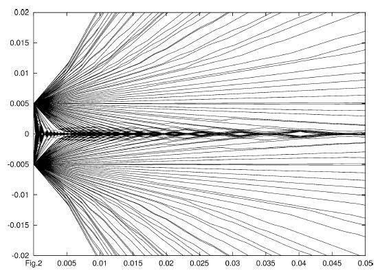

The following image is from from the article, Bohmian trajectories for photons, by Partha Ghose, A.S. Majumdar, S. Guhab, J. Saub, Publication: 19 November 2001, Physics Letters A 290 (2001) 205–213 found @ http://web.mit.edu/saikat/www/research/files/Bohmian-traj_PLA2001.pdf
Its accompanying caption says: "Fig. 2. Bohmian trajectories for a pair of photons passing through two identical slits. Note that there is no crossing of trajectories between the upper and lower half planes."
I look forward to studying this article in greater detail.
I note that the photon trajectories - representing real particle photons according to Bohmian Mechanics - are clearly shown as being non-straight.

You say this like it's obvious that 'photon trajectories' should be straight in this situation. Did I misunderstand this, or do you have a particular reason for thinking so?
PRODOS, in some situations the Bohmian velocities of photons may be larger than c. Nevertheless, this is not a problem. By using the general theory of quantum measurements, it can be shown that the Bohmian velocity of photons is exactly equal to c whenever you measure this velocity.

For clarity, I'd better present the question again with the correct picture ...
PRODOS said:

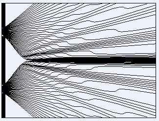

[... Updated version of original post to show correct Bohmian photon particle paths, including some minor edits to text ...]
In the double slit experiment, http://plato.stanford.edu/entries/qm-bohm/#2s" the paths of real particle photons traveling from the two slits to the detector to look something like this:
(Thanks to https://www.physicsforums.com/member.php?u=168088" for pointing me to this paper)
The above image shows photon particles traveling in non-straight paths.
b > s
s/c
Either:
Or:

PRODOS, this velocity can be many times faster than c. In fact, it can even be infinite. Nevertheless, it has nothing to do with nonlocality in EPR experiments because the exchange of photons is NOT the mechanism of communication between entangled particles.
A typical situation in which such ultra-high velocities occur is a wave function which is a superposition of two different frequencies.
Concerning the application of quantum measurements to such situations, I would say that it is a standard aspect of BM, although it has been explicitly stated relatively recently.
