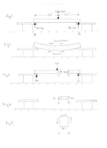

I've been thinking a bit more about the issue.
7 ft x 3ft 6ish is about the size of a door.
Modern doors are not solid but of cellular construction, very often with a honeycomb like cardboard core and two very thin skins of veneer to form the faces.
I think that such a door, laid across two tables, would support a teacher who had had too much Jack Daniels.
So how does it work?
Well I've attached some sketches. Ignoring the weight of the plank.
Fig 1
Has the door or plank laid so it is spanning across two tables. In the centre is a 160 lb load.
In order to maintain vertical equilibrium the support reactions at A and B must together equal this load.
By taking moments we can show that they must be equal and half the 160. If the 160 load where placed elsewhere we could use moments to calculate the reactions.
There are no horizontal forces acting.
This condition is know as 'simply supported'
Fig 2
This shows what really happens, but exaggerated. The plank deflects as shown. The top surface becomes shorter and is in compression. The bottom surface is stretched in tension.
The reactions are still the same as the loads have not changed.
Fig 3
Suppose we cut out a section of plank, immediately to the right of the load. This forms what is known as a free body diagram of the left hand part of the plank.
Now if we look at the vertical equilibrium of this isolated piece of plank we see that the missing piece must have been exerting an upward force on the left hand chunk of plank as the only other two vertical forces acting are the load and the reaction at A.
This force must act upwards and I have shown it with a half head arrow.
Similarly there must be a downward force acting on the remaining length of plank at the right hand end.
Fig 4
This time I am showing the missing bit of plank as a free body diagram.
Since it was exerting an upward force on the left hand piece in Fig3, the left hand piece must be exerting a downward force on it (action and reaction). And the same on the other side.
I have shown these on the sketch.
Since these vertical forces are equal an opposite they form an anti clockwise couple.
Fig 5
Now comes the clever bit.
We know that this chunk of plank is in equilibrium.
Therefore there must be another couple acting on it, opposite to the vertical forces in Fig 4.
This is provided by a pair of equal and opposite horizontal forces shown in the sketch.
These correspond to the compression and tension noted in Fig 2 and are the method by which the structure (plank) distributes the loads imposed upon it.
I will not prove, just state that most of the tension is transmitted near the bottom surface and most of the compression near the top.
This is why the cellular door type construction would work, so long as you could laminate sufficient layers of cardboard to be equivalent to the veneer skin of the door. This would also provide sufficient surface strength for the teacher to walk on.
No doubt you will have questions.

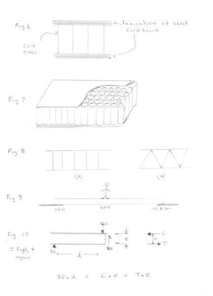

Anyway to continue. You haven't indicated what sort of cardboard is available - you will perhaps need to discuss with your teacher. I am assuming you are going with the cellular 'door' approach. (Corrugated will not do see Fig 8.)
Fig 6
Shows a section of the construction with laminated skins several sheets thick and cardboard tube cells, probably similar to the centres of toilet rolls.
Fig 7
Shows a cutaway drawing of the arrangement. The stack of tubes is much stronger for this application than the typical corrugated cardboard construction which looks like Fig 8 (b)
Fig 8
Shows alternative spacing arrangements can you see why (a) representing the cells is stronger than (b) ? A good point to discuss with your teacher or in your report.
Fig 9
This answers your question about abutments / bearing areas. Since someone will walk across the walkway and could stand anywhere, the space he occupies has to be able to support him, on one foot as he walks. This space is just under 1ft of beam and is labelled A.
Since one end reaction is equal to the full 160 lbs when the man is standing at that end the reaction will need a similar area to bear upwards on. So the bearing length will be about 1 ft.
Fig 10
Here we go back to the analysis in Figs 3 nd 4 with some numbers.
The couple (clockwise this time) is formed by the 80 lb reaction and the (160 - 80) forces acting wherever the man is standing. The magnitude of this couple is therefore 80d where d is the distance from the support.
This reaches a maximum when the man is halfway.
This couple or moment is countered by the horizontal forces in the skins. Now this couple has a substantially shorter lever arm I have labelled e. Since the Tension = Compression the couple = Ce or Te.
Thus Ce = 80d.
C = 80d/e
Thus the magnification factor if d is 42 inches and e is 2 inches is 21 times or 1680 lbs.
Now you can see why engineers like beams to be as deep as practicable.
You can get an idea of the tensile strength of your cardboard laminations by making a strip and measuring its breaking strength.
The cellular construction should be enough to stabilise the compression skin against buckling which is the reason why thin cardboard has difficulty with compression.

Please correct me if I am wrong, but for this cellular door application here is that I would mean I would create many "toilet paper rolls" and stack them vertically?
Or b.) I am just stacking non corrugated cardboard on top of another to create one large beam?
A standard door is around inch and a quarter to inch and a half thick.
Since the veneer skins will be stronger than your cardboard I suggested looking at a figure of around 2 inches for your beam.
To be quite clear.
The main forces are in the skins. A single sheet of cardboard will be inadequate so I suggest gluing several together like plywood. Simply stacking them would not be enough they would not act as one.
I suggested some experiments to determine how many layers, sheets or laminations or plies your would need.
Read this bit again.
The purpose of the arrary of tubes is to keep the skins apart. The further you can separate them the less the skins are stressed. You will need to stand the tubes up like a single layer of tins of beans and glue them to the skins and to each other.
They obviously have to transmit the vertical force from the top to the bottom.
Did you look at the question I posed for Fig 8? The cellular construction is also important as it prevents the whole structure collapsing due to both the horizontal and vertical forces acting.
Take your time and work it through. Also talk it through with your teacher. You can learn a lot from this exercise.
