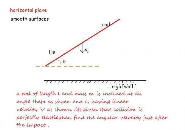

Please refer the attachment.
Conserving angular momentum about the point of rotation,
mvolcosϑ = ml2w/3 + mVl/2
Since collision is perfectly elastic, kinetic energy is conserved.
mvo2/2 = (ml2w/3 + mV2)/2
Solving both I got a quadratic equation in w. Please tell if there is something wrong.

Please tell me where your point of rotation is and what is V.

It seems to be that you're messing up with the numbers. I'll comment on the correctness of each term first (that means, I'm not saying anything about whether your approach is correct).
_ For the 1st equation:
From the way I understand, you choose to consider the point of contact (lowest end of the rod). That's why you thought the angular momentum about that point was conserved, right? If so, then all the 3 terms are incorrect.
The LHS should be: [tex]\frac{1}{2}mv_olcos\theta[/tex] . Notice that vector [tex]\vec{v}_0[/tex] is placed in the MIDDLE of the rod.
The RHS should be: [tex]\frac{1}{12}ml^2\omega - \frac{1}{2}mVlcos\theta[/tex].
This comes from the KOENIG theorem for angular momentum: [tex]\vec{L}_{rod-about-A}=\vec{L}_{COM-about-A}+\vec{L}_{rod-about-COM}[/tex] (where A is the point of contact, COM stands for center of mass). Notice that [tex]\vec{V}[/tex] points vertically upwards and is placed in the MIDDLE of the rod. Besides, the angular momentum conservation equation is a VECTOR equation, and vectors can have different directions. When we project the vectors onto an axis, they can have either positive value or negative value! The minus sign before the 2nd term is due to that reason (did you notice that [tex]\vec{v}_0[/tex] and [tex]\vec{V}[/tex] had opposite directions? :wink:).
_ For the 2nd equation:
The 2nd term in this equation is wrong. The moment of inertia of the rod about its COM is mL2/12. This also comes from the KOENIG theorem for kinetic energy:
[tex]K_{rod} = K_{COM} + K_{rod-in-reference-frame-of-COM}[/tex]
So that's all with the terms. Now about your approach, I would say the part about angular momentum conservation is wrong. It's not because you don't understand; it's because the mistake is a very very subtle point about angular momentum that many introductory textbooks ignore. Caution must be taken when dealing with angular momentum. Going into detail about this takes time, so I'll leave it aside (if you're interested, you can search my replies to topics by PhMichael; I remember that I once discussed about it somewhere). Usually there are 2 cases that we can be confident when applying the angular momentum conservation:
_ When the point A (the point about which we calculate angular momentum) is a fixed point, provided that the total torque about A is zero.
_ When the point A is COM, provided that the total torque about A is zero.
In this problem, A (the point of contact) is neither a fixed point nor COM, so we should avoid any equation related to angular momentum about A. Instead we can consider COM (so that we can write down equations without reservation!). Let X denote the impulse by the ground, then it obviously points upwards.
_ From Newton's 2nd law: [tex]X = m(V - (-v_0))[/tex]
_ Since X also creates a change in angular momentum about COM: [tex]Xlcos\alpha = \frac{1}{12}ml^2\omega[/tex]
(this comes from this popular equation: [tex]torque = FL = I\gamma = Id\omega/dt[/tex]
thus: [tex]I\int d\omega = L\int Fdt = LX[/tex])
From the 2 equations, we obtain the relation between V and w. Plus the energy conservation equation, the problem is solved :smile:

Thanks a lot for your detailed reply.
The only thing wrong in my approach was that I considered angular momentum about point A.
Now if I consider Angular Mometum about the COM,
mvolcosϑ/2 = ml2w/12 + mVlcosϑ/2
from here,
cosϑ(vo - V)=wl/6
I thought of a new approach from here :biggrin:
What if we apply Newton's Law of restitution with e=1
i.e. evo= -V
I got w=12vocosϑ/l
I guess u meant Xlcosα/2=ml2w/12
Using your idea, I got

I'm not familiar with Newton's law of restitution, but one question: Is the law proved to cases where rotational motion is taken into account?
And I cannot read our final result (check your Latex code :rolleyes:). Anyway, one problem:
Is the torque about COM equal to zero?
I think it would be right and much easier to conserve angular momentum about the point of contact with the floor as the unknown impulse passes through that point and generates no torque about it.In that regard you have already done that although you think otherwise-a translating body can not have angular momentum about it's centre of mass and the first term should have been zero. Anyways it would be wrong to conserve L about com because of the impulsive torque of the reaction of the ground.

Torque about COM will be 0 if we consider the wall and the rod as our system.
If we take only rod into consideration, torque will not be 0.

Newton's Law of restitution is valid if we take the rotation and translation about Centre of mass only. Moreover, cosϑ term won't be there. Vc will be positive (if it is negative, w(l/2) should also be negative)
V + wl/2 = vo
But substituting this in the equation
cosϑ(vo - V)=wl/6
we get a value of cosϑ as V vanishes
I think the energy conservation is the best approach!

Then you have to take into account the angular momentum of the wall (or earth). Not easy though!
(notice that the velocity of the Earth due to the impact seems to be negligible, but its mass is huge and so is its moment of inertia. In the end, its angular momentum may be significant)
EDIT: By the way, COM of the system is not COM of the rod.

Eek, you should recheck the formula. Why is there omega in the final answer?
Anyway:
_ From 2 equations of post #6:
[tex]X = m(V+v_0)[/tex]
[tex]Xlcos\theta/2 = ml^2w/12[/tex]
We have: [tex]wl = 6cos\theta(V+v_0)[/tex]
_ From energy conservation law: [tex]0.5mv_0^2=0.5mV^2+0.5\times m(wl)^2/12[/tex]
From those 2 equations, you get a quadratic equation. Solve it for V. One solution is [tex]-v_0[/tex], which is eliminated due to that if [tex]V=-v_0[/tex] , there would be no change in COM's velocity, which means there would be no impact / collision at all (X=0!), and that's impossible.
OHH! I forgot that we had to find an expression for Angular velocity and not V.
I got this answer
w= vo(1-3cos2ϑ)/(1+3cos2ϑ)
Thanks for spending your precious time :smile:
