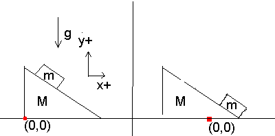

simple question: a movable block on a movable wedge on some frictionless ground. we know all masses, angles, and there is no friction. the block starts on the wedge at some height h, and slides down the wedge. the block moves forwards, and the wedge moves backwards. what is the velocity of the wedge, the moment before the block hits the ground - i.e. block still on wedge?
i tried this question. however, i could only get the velocity of the wedge, after the block is totally off the wedge by conservation of energy and momentum.

yeah, i want the total velocity of the little block. however here are the conservation equations:
Energy Initial = mgh
Energy Final = 1/2 M(velocity of wedge)^2 + 1/2m(velocity in horizontal direction of little block)^2 + 1/2 m(velocity in vertical direction of little block)^2
P Inital = 0
P final = M(velocity of wedge) + m(velocity in horizontal direction of little block)
however, it is not true that tan(angle of wedge)=(velocity in vertical direction)/(velocity in horizontal direction).
as this assumption is only true when the wedge is unmoving, however since this is a free wedge, this is not true in the centre of mass reference frame.

But with respect to the wedge the velocity of the block is parallel to the wedge. Try expressing your equations in terms of the speed of the block with respect to the wedge. And note that the wedge only moves horizontally.

Let's call [itex]a[/itex] the horizontal acceleration of the wedge.
The tilted surface will accelerate *perpendicular to itself* by [itex]a\ sin \alpha[/itex].
So the block will experience an acceleration perpendicular to the surface [itex]g\ cos\ \alpha -a\ sin \alpha[/itex].
Thus the force perpendicular has to be [itex]m(g\ cos\ \alpha -a\ sin \alpha)[/itex].
This is the force [itex]F[/itex] that will push the wedge. Horizontally acceleration will be only: [itex]F\ sen\ \alpha / M[/itex].
This will again give an expression for [itex]a[/itex].
So we equate [itex]a = {m \over M} sen\ \alpha(g\ cos\ \alpha -a\ sin \alpha)[/itex].
Ok, so with this last equation, we have the acceleration of the wedge.
Then we can find again the acceleration of the wedge surface *perpendicular to itself*.
This will be as well the acceleration of the block perpendicular to the surface.
Now we know all the accelerations on the block. We can find how long does it take to hit the ground

Consider the motion of thee block on the movable wedge. Consider the co-ordinate axis such that x-axis is parallel to the inclined plane of the wedge.
When the wedge moves through a distance X horizontally, block moves through a distance y perpendicular to the wedge surface such that y = X*sinθ.
Hence ay = A*sinθ ...(1), where A is the acceleration of the wedge.
Now consider the force equations.
For wedge: N*sinθ = M*A...(2)
For block: mg*sinθ = m*ax...(3)
mg*cosθ - N = m*ay...(4)
substitute the value of ay from eq.(1) in eq.(4) and find N.
Substitute this value in eq.(2) to find the acceleration A of the wedge.

I've found this problem can be done in two possible ways, (which both get the same answer).
First way) use conservation of energy and horizontal momentum along with the fact that the block stays on the surface of the wedge.
Second way) simply resolve the forces on the two objects, and use the fact that the block stays on the wedge.
For either method, you need to do a bit of differentiating and rearranging to get the answer. (Which is a slightly complicated expression).
