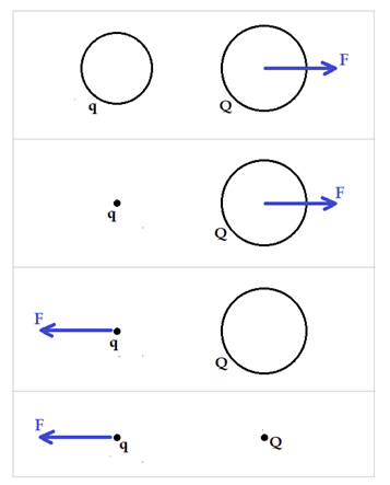

I am puzzled about something we take for granted but somehow it doesn't seem so obvious to me:
Let's assume that the two spheres do not interact via electrostatic induction, so no redistribution of charges on their surface. So there is uniform distribution of charge on their surface.
Why do we take for granted that the coulomb force in this case would be as if the whole charge was concentrated at the center of the spheres? We have to do integration to see it or is there some other argument?

I don't think any integration is required if you already know (e.g., from Gauss' law) that a sphere with charge q uniformly spread on its surface produces an electric field outside the sphere that is identical to the field produced by a point charge q located at the center of the sphere.
See if you can argue without any mathematics that the force F in each figure below has the same magnitude.
Hopefully the meaning of F is clear in each diagram. For example, in the top diagram, F is the force on the right sphere produced by the left sphere. In the second diagram, F is the force on the right sphere if the left sphere is replaced by a point charge at the center of the left sphere. Etc.
I think integration gives you the same result.
Using gauss law, by taking a spherical gaussian surface and computing the elctric field, will be much easier.
Another way to think is in terms of centre of charge (like centre of mass).
Every distribution of charges can be simplified to a point charge (position of the point charge will vary depending upon config). The sphere has a spherical symmetry (obviously!) So the uniformly distributed sphere can be considered to be a point charge located at the centre.
You may use symmetry arguments to state that the direction of the force will be along the line joining the centres of the sphere.
Likes Delta2
Ok, @TSny I can see it now, I don't have to do integration but I 've to use Newton's 3rd law (if I am not mistaken) to conclude that the force between 2nd and 3rd picture is the same.
Likes JD_PM, Shreya and TSny
Yes. Newton's third law holds for two point charges at rest. The superposition principle then implies that the third law holds for two arbitrary, static distributions of charge.
