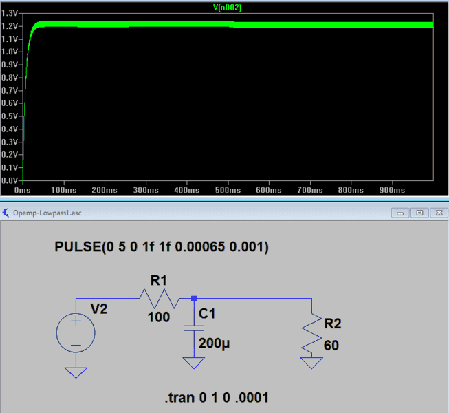

I should clarify that I'm not actually trying to switch the relay on and off with a PWM signal, a PWM is just what's available to me. My plan was to pass the PWM signal through a low-pass filter, then vary the duty cycle (either 0% for on or some other % for on), as shown in the attached picture.

Supply voltage means the mains supply.
If you just want to turn the relay on or off, you could certainly do that.
The action would take place at the next zero crossing, so within 1/120th of a second.

Okay, good. I am essentially hoping to use a variable PWM and a low-pass filter as a variable DC voltage. Although, the board is also capable of digital output at +5V, +0V. Would it be sufficient to drive the relay using just a 178-ohm current-limiting resistor? In the picture, I did not mean to make it look like the SSR inputs were connected :P.
This would, in theory, put the SSR in its operating range of 1.2V/20mA when Vout is +5. Does that sound right?

Yes that seems OK.
3.8 volts / 0.02 amps is 190 ohms, so a 180 ohm resistor would be the nearest standard value.
Be careful.
Why do you want an analog voltage signal? From the data sheet, I see what you mean when you theorize that this is a current controller device. It seems that applying a current source of 20mA to the input pins should close the relay, and 0.1mA will open it on the next zero crossing. I agree you should use a digital output of the MCU through a current limiting resistor to accomplish this, although you may consider using the digital pin to drive a transistor as shown in the datasheet under Standard Circuit.
