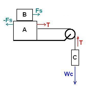

Block B, with mass 5.00kg, rests on block A, with mass 8.00kg , which in turn is on a horizontal tabletop. There is no friction between block A and the tabletop, but the coefficient of static friction between block A and block B is 0.750. A light string attached to block A passes over a frictionless, massless pulley, and block C is suspended from the other end of the string.
F=ma
FFriction = μN
What makes sense for me to do is to find the tension in the string which I think is equal to the force due to gravity on block C. What throws me off is that the force of friction between B and A is in the same direction of the Tension force of the string.
I tried to set up a net force equation of B and got
F = FgravityonC - Ffriction = 0
But then the answer I get (3.75kg) is wrong. I'm not convinced that FgravityonC is supposed to be in the equation. And I haven't addressed block A at all.
Please give me a prod in the right direction!

I was only looking at the maximum acceleration possible for Block B. Block B is accelerated by a friction force from block A. Remember, the string is not tied to Block B. The tension force is transferred vis Block A in the form of the Friction force.
It is difficult to speak about Physics problems without a picture, so I show one. I drew all forces which act in the possible direction of motion, which is on the right for the boxes A and B and downward for box C. They move with acceleration of the same magnitude.
There are the weight Wc and the tension T of the rope acting on box C.
a*Mc=Wc-T.
Only one force acts on box B: the static friction between A and B, Fs. This force counteracts any relative motion of the surfaces in contact, so it points forward as A moves forward.
a*Mb=Fs
ehild
The tension pulls box A forward but the static friction from B acts backwards, according to Newton's Third Law.
a*Ma=T-Fs
The tension and the friction are internal forces, they act in pairs, and have opposite direction for the interacting objects.
If you add all three equations, the internal forces cancel, and only the external force(s) remain. It is Wc now:
a(Ma+Mb+Mc)=Wc, that is a=g*Mc/(Ma+Mb+Mc)
Having obtained the acceleration, you need to check if the static friction can provide enough force to accelerate box B.
Fs≤μ*NAB=μ*Wb.
To accelerate B, F=a*Mb force is needed. So check if a*Mb≤μ*Wb, or eliminating Mb,
a≤μ*g

Having seen the diagram drawn by echild I realize two things:
#1 I mis-interpretted which block was where [A & B]
#2 There is no question mark in your original problem statement, clearly showing that you gave a lot of information but told no-one what you might be trying to calculate.?

Wow that was very silly of me. Yes, my question was what is the maximum weight object C can be. I've learned a lot by this problem, namely that object B actually 'pulls' object A in the opposite direction on T. Thanks for all the help.
