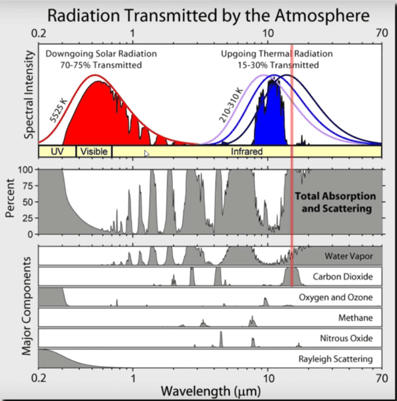

TL;DR Summary
If the transmittance of IR to space is already zero in CO2 bands, how can adding more CO2 change anything?
This is a serious question, and it is not meant as an attempt to "debunk" greenhouse warming of the earth.
Wikipedia has the below image, which shows the atmospheric transmittance as a function of wavelength. Notice the red vertical line through one of the CO2 absorption bands. We see that the light emitted in that band is nearly totally absorbed by the CO2 in the atmosphere, i.e., the transmittance is near zero in that band (and the same for the thinner band at shorter wavelength). Now the question arises: how could adding more CO2 make it so that even more light is absorbed in that band, when all the IR emitted in that band is already absorbed by CO2?
My understanding is that the AGW hypothesis is that IR emitted from the ground is absorbed by CO2 in the atmosphere and this prevents it from getting to space and thereby cooling the earth. If this is so, then isn't the atmosphere already at a point where it cannot absorb more (than 100%) of the light in that band?

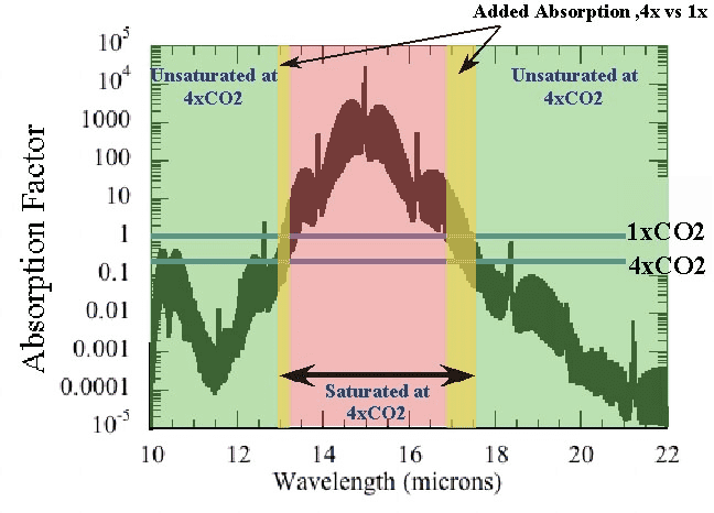

He displays a graph that shows the impact of "Increasing α." This shows the range of wavelengths absorbed gets extended with increased α. What he doesn't say is why α would increase in the first place. Does he mean the absorption would increase on the edges of the absorption band (where saturation has not been reached) because of increasing concentrations of CO2? If that is correct, then can I summarize as below?
Though there are some places on the emitted spectrum where the absorption is saturated (in the center of the absorption bands), increasing CO2 concentration increases absorption in those frequencies (on the edges of the absorption bands) which are not currently saturated.
Is that an accurate summary? If so, then two interesting questions arise.
1. How much would the edges contribute to overall absorption (percent-wise), even if they became saturated?
2. What level of CO2 would saturate all the bands?
Thanks again. I think I may be getting a clearer picture of what the skeptic is saying, and why it is not quite right.

I don't fully understand the physics of how the bands widen with concentration, but from what I read this is overall a minor effect. I've found this graph on some sites discussing CO2 saturation:
(although I can't identify the primary source, might be database-generated; to be found e.g. here:
http://www.realclimate.org/index.php/archives/2007/06/a-saturated-gassy-argument-part-ii)
which suggests that while there is no theoretical cut-off that would fully saturate all bands, the additional energy stopped is relatively minor even as the CO2 concentration increases manyfold.
The main effect seems to be the one discussed earlier on the site, i.e. the layered nature of the atmosphere.
