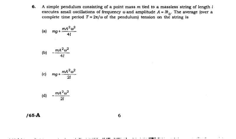

Average tension force acting on a simple pendulum
In summary, the maximum tension force is mg, so the average has to be less than this. Hence, the option (a) and (c) are not correct.
Pushoam
962
52
Trying to answer it before solving it,
The maximum tension force is mg, so the average has to be less than this. Hence, the option (a) and (c) are not correct.
## T = mg \cos \theta ##, where ## \theta ## is the angle between the string and the vertical axis.
Now, ## \theta = \omega t##
So, ##<T> = \frac { { \int_{ T}^{2T } mg \cos { (\omega t)} dt} } {\int_{ T}^{2T } dt } = 0.##What is wrong here?
Is it? Why?
haruspex said:
Is it? Why?
Because T = mg cosθ
Pushoam said:
Because T = mg cosθ
What is the acceleration of the mass when the string is vertical?
It is 0. So, T = mg when the mass is not moving.
Pushoam said:
It is 0.
So, at the bottom of the arc the mass is moving with constant velocity? Seems a bit contradictory.
Yes, at the bottom, there is no acceleration.
The bottom is the point of stable equlilbrium. So, the net force is 0 at this point.
The acceleration is ## g\sin\theta## and so it is 0 as ## \theta## is 0 at bottom.
I don't see what is contradicting it. Will you please give me a hint?

The bob passes along an arc, not a straight line. While it is moving it is therefore accelerating. What is the usual name for that acceleration?
It is centripetal acceleration which keeps a body moving into an arc.
But, we are considering locally.
For ##d\theta ## around ##\theta = 0##, the arc could be taken as a straight line. Well, I am not writing this to cut your suggestion. I am writing it as I am getting this thought, too, and I want to get this thought checked by you.
Pushoam said:
For dθ around θ=0, the arc could be taken as a straight line.
To a first order yes, but acceleration is second order.
You know what the formula is for centripetal acceleration, so use it. If your argument were correct it would give zero, but it doesn't.
The bob is not moving in the radial direction, so, I took the centripetal acceleration to be 0. I think this is the mistake.
I should follow Newton's law explicitly.
Taking origin of the polar coordinate system at P,
##\vec F = (T – mg \cos { \theta } )~\hat r – mg \sin { \theta } ~\hat {\theta} ## ………..(1) wrong
I am editing the following after getting the suggestion from haruspex in post 16.
I have taken the wrong sign of forces in radial direction.
The correct one is
##\vec F = (T – mg \cos { \theta } )~(-\hat r) – mg \sin { \theta } ~\hat {\theta} ## ………..(1) correct## \ddot {\vec r} = - r {\dot \theta }^2 ~\hat r + r \ddot \theta ~\hat {\theta} ##, taking ##\dot r = 0## ……….(2)
## - r {\dot \theta }^2 ~\hat r = \frac { 1 } {m } (T – mg \cos { \theta } )~\hat r##.... wrong
## r {\dot \theta }^2 ~\hat r = \frac { 1 } {m } (T – mg \cos { \theta } )~\hat r##....correct
So, at ## \theta = 0##, acceleration is not 0.
The radial acceleration is non- zero, ## a_r = - r {\dot \theta }^2 = \frac { 1 } {m } (T – mg \cos { \theta }) ##....(3).....wrong

So, for calculating < Tension >, I have to express tension in terms of ## \theta = \theta ( t)## and then I have to take the average of tension over one time period T.
Solving equation (3) with the approximation ## \sin { \theta } = \theta ## for small ## \theta ## gives,
In equation (3), it is ## \theta ## which oscillates with angular frequency ## \omega = \sqrt{ \frac { g} {l }} ## where l is the length of the string.
I note that ## \dot \theta ## may or may not be equal to ## \omega ##.
## \theta (t) = A \cos{ \omega t} + B \sin{ \omega t}##
Taking at t = T/4, ## \theta (T/4) = 0## and at t = T, ## \theta (T ) = \theta _0##,## \theta (t) = \theta _0 \cos{ \omega t} \neq \omega t##
## \dot \theta = -\omega \theta _0 \sin{ \omega t} \neq \omega ##
Tension, ## T = m( g \cos{ \theta } + l (\dot \theta )^2) ## ...(5)
Is this correct so far?
Now, approximating ## \cos{\theta } as 1##,
## <T> = mg + \frac 1 2 m g {\theta_0}^2 = mg + \frac {m { \omega}^2A^2}{ 2l} ##

What is wrong there is:
1) The acceleration at ## \theta = 0 ## is 0. So, the maximum tension is mg.
The correct thing is acceleration at ## \theta = 0 ## is not 0.
At ## \theta = 0, a_r = l {\dot {\theta}} ^2, a_{\theta }= 0##.2) ## \theta = \omega t ##
The above equation is valid for uniform circular motion. It is not valid every where.
I have a tendency to use it whenever I see ## \omega ~ and ~ \theta ##.
Here ## \omega \neq \dot {\theta} , ~and~ \theta \neq \omega t##.Is this correct?

Pushoam said:
##T = m( g \cos{ \theta } + l (\dot \theta )^2)##
So, my final answer should remain the same i.e. option (c). Right?
Check what happens if you use a more accurate approximation for cos(θ).
Pushoam said:
Tension, ##T = m( g \cos{ \theta } + l (\dot \theta )^2) ##...(5)
Now, approximating cosθ as1,
##<T> = mg + \frac 1 2 m g {\theta_0}^2 = mg + \frac {m { \omega}^2A^2}{ 2l}##
l
## \cos{\theta} = 1 - \frac {{ \theta}^2} 2##
##< {\theta }^2> = {\theta_0}^2/3##
So, ##<T> = mg - \frac { mg{\theta_0}^2} 6 + \frac { mg{\theta_0}^2} 2= mg - \frac { mg{\theta_0}^2} 3 = mg + \frac { m {\omega }^2A^2}{3l}##
So,this means that ## mg< \left <T \right > < mg + \frac { m {\omega }^2A^2}{2l}##.Thanks for taking me to more accurate approximation.
But, I am not seeing the significance of it. Is it only for mathematical calculation or is there anything to appreciate in it which I am missing?
Do you mean that if we take more order of correction, then <T> will go to ##mg + \frac { m {\omega }^2A^2}{4l}##?
But, I have taken ## \sin \theta = \theta##, so will it make sense to take more correct order (more than 1st order) of approximation for ##\cos \theta##?
Shouldn't I take ## cos\theta = 1##, when I take ## \sin \theta = \theta##?

Pushoam said:
Shouldn't I take ##cos\theta = 1##, when I take ##\sin \theta = \theta##?
Zeroth order: sin θ=0, cos θ=1
1st order: sin θ=θ, cos θ=1
2nd order: sin θ=θ, cos θ=1-½θ2
3rd order: sin θ=θ-θ3/6, cos θ=1-½θ2
Etc.
No, that results from integrating wrt θ. We want the average over time, so an integral wrt time.
Likes Pushoam
I thought that ##<\theta ^2> ##with respect to ## \theta ## going from ## -\theta _0 ~to~ +\theta_0 ## is equal to ##<\theta ^2>## over one time period T. But it is not so. I don’t see why I am inclined think that they should be equal but they are not.
So, average of a function depends upon the variable with respect to which I want to calculate the average. It is not independent of the variable.
Here I am having some misconception. And I feel that I may do this mistake again if I don’t become clear about what I have understood wrongly.With respect to time, ##<\theta ^2> = \frac { {\theta_0 }^2} 2##, which gives me the required result, ##<T> = mg + \frac { m {\omega }^2A^2}{4l}##
##\int \theta^2.dt = \int \frac{\theta^2}{\dot \theta}d\theta##
Maybe, but how do you get that?
Pushoam said:
With respect to time,## <\theta^2> = \frac {\theta_0 ^2}2##
## \theta (t) = \theta _0 \cos{ \omega t}##
##<\theta ^2>= {\theta_0^2 } <(\cos{ \omega t})^2> ## ##= {\theta_0^2} \frac { \int_{0 }^{T }{ (\cos{\omega t}})^2 dt}{ \int_0 ^T dt} ####\int_{0 }^{T }{ (\cos{\omega t})}^2 dt = ## ## \int_{0 }^{T } \frac { \cos{ (2\omega t)} +1}2 dt =## ##\frac { T} 2 +\frac { \sin{ (2\omega t )}}4|_0 ^T = \frac { T} 2 +0 = \frac { T} 2 ##
as ## {(\cos{ \omega t})}^2 = \frac { \cos{( 2\omega t)} +1}2 ##
## <(\cos{ \omega t})^2> = \frac 1 2 ## over one T.
##<\theta ^2>= {\theta_0 }^2 <(\cos{ \omega t})^2> = \frac { {\theta_0 }^2} 2##
I hope now this question is solved.

  • #31
Pushoam said:
in what way is it wrong?
Consider e.g. average fuel consumption. That should be an average wrt distance. If you were to average over time instead, consider a journey at varying speed. While going slowly, more time is spent over each equal distance, so that would make those fuel measurements count more.
  • #32
Yes, this means that if I go slowly, I will spend more fuel, isn't it so?
Does this mean that the spent fuel is independent of speed?
If I consider conservation of energy, the more speed means more kinetic energy, so more fuel is needed as fuel is the energy which gets converted into the kinetic energy for a car to reach greater speed. So, this means that the rate of fuel spent per unit time that is input power is more if the car is accelerating.
I think you suggested to consider an unaccelerated moving car.
If a car is already moving at constant speed v, then the fuel is needed to counter the friction force, not to keep the car moving at speed v. And the friction force is independent of speed. The fuel is equal to the |friction force| *distance, which is independent of v.
So, the amount of consumed fuel depends upon the traveled distance, not time or speed.
So, the average of consumed fuel should be calculated wrt to distance.
Now, I have to answer, why should ##<\theta^2> ## be calculated wrt time not ## \theta##?
  • #33
Pushoam said:
Now, I have to answer, why should <θ2> be calculated wrt time not θ?
The first thought which I am getting is : θ2 depends on θ and θ depends on time t explicitly. So, <θ2> should remain same. But, I know that it is not so as I found them different after calculation. So, I leave this expectation.
Now, why should <θ2> be calculated wrt time not θ?
I am not getting how the fuel example helps to know the answer to the above question.
Is this because while calculating <T>, I have calculated average of other terms wrt time t, not θ?
Another thought:
The question asks to calculate <T> wrt time t over one time - period, not θ. So, <θ2> should be calculated wrt time t,not θ.
