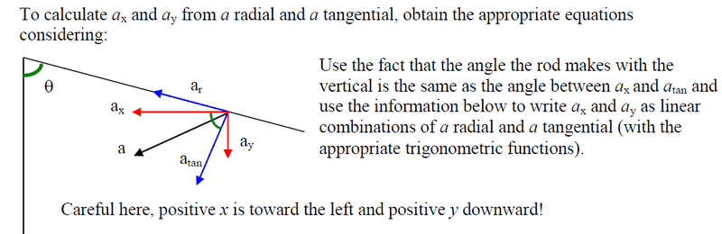

The problem is about a rod that is set in a pendulum way but that has an angle high enough so the SHM doesn't apply to it. It starts at Pi/2 until it reachs 0. I was able to find the tangential and radial acceleration about the center of mass but now I need to know the x and y acceleration about the center of mass.
It says that I should be using the angle between Atan and Ax as a reference
Completly stuck!
the only difficulty is working out the angle between tan (or rad) and x (or y) …
the hint is simply telling you to write those angles as either ±θ or ±(90° - θ) …
go for it! :wink:

Thanks u did put me on the track, I do possesses all the θ already for a definite period of time. Actually, correct if I am wrong, if I have and angle of 1.40 rad, then if if i do pi/2 - 1.4, which will give me something around 0.17 rad.
From there, i know that the angle between arad and ax is 0.17 rad, the same angle betweenay and atan. I would then be tempted to simply do ax = ar cos 0.17. However, I cannot assume that they form a right angle triangle. Anymore inputs?
i'm confused :redface: … there's right-angles everywhere …
which angle isn't a right- angle? :confused:

Well between Ar and Ax, If u look at my attached image, you will see that I cannot assume that they are parts of a right angle triangle. Ax seems to long to be the hypothenus of Ar, doesn't it?
the length doesn't matter
all you need is the angle between ar and ax

Thanks, I went over the internet and I have found the solution. I have to express as linear combination of the Ar and Atan.
It sums up to Ax = Ar cos (90-θ) + Atan sin (90-θ)
Ay = -Ar sin (90-θ) + Atan cos (90-θ)
