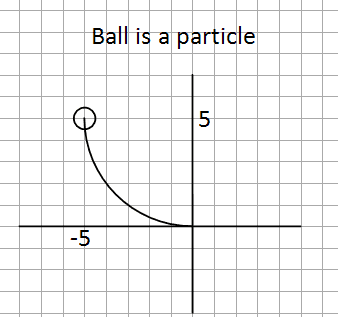

Quarter-Circle radius 5 starting at (-5,5), ending at (0,0), centre at (0,5).
Ball mass 2.1kg is let go vertically at (-5,5) and left to slide down the slope.
The ball can be assumed to be a sliding point mass.

s_0 = (-5,5)
v_0 = (0,0)
a_0 = (0,-9.8)
v_f = (sqrt(2*9.81*5),0) = (9.90, 0)
s_f = (0,0)

ok, so the parametric equation for a circle radius 5 origin 0,5 is
[tex]y = 5cos( \theta )+5; x = 5sin( \theta )[/tex]
or in Cartesian form
[tex](x)^2 + (y-5)^2 = 25[/tex]

I had another go at it, this is as far as I got:

See http://imgur.com/EutWV.png
