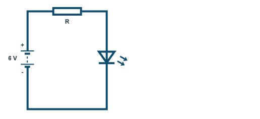

We were (trying to) discussing this at work the other day. Consider a simple battery powered circuit, with a resistor and an LED. With a battery, current is "chemically produced" in the battery and flows from the positive to the negative pole, passing through the LED (limited by the resistor) and "returning" (?) to the battery's negative pole. This is a correct summary?
But what if we disconnect the battery's negative pole, and connect the LED's cathode to "ground/earth" instead? Like, a big ol' iron pole into the ground. Theoretically, this should make no difference in terms of the curcuit, but would current still flow from the battery? If so, would we somehow destroy the battery?Joakim

The battery is open circuited until you complete the circuit with the second ground. It will not magically push electrons through the circuit without that completion.
Joakim said:
But what if we disconnect the battery's negative pole, and connect the LED's cathode to "ground/earth" instead? Like, a big ol' iron pole into the ground. Theoretically, this should make no difference in terms of the circuit, but would current still flow from the battery? If so, would we somehow destroy the battery?
then you have an open circuit ... that is the circuit isn't complete ... so no current can flow
if you do as Bystander said, and connect the negative of the battery to the ground as well and there isn't too much ground resistance between the 2 Earth stakes,
then the LED may still light up

Joakim said:
-- does current HAVE TO "return" to the battery
Yes.
Many people think "ground" has some magical affinity for electric current.
I think that comes from the "Water Analogy" .
Water runs out the end of our garden hose and is pulled to ground by gravity. And when we lift water above ground we increase its graviational potential energy.
Electric charge is (so far as i know) unaffected by gravity .
"Ground" (i much prefer to call it Earth) is, for circuits, nothing but another wire that happens to go almost everywhere.
If current can get back to its source by going through ground, Kirchoff's Laws say it probably will.
But it has no reason to prefer that path homeward over a copper wire.
Your flashlight is oblivious to whether it's resting on the ground or hung from a skyhook.
