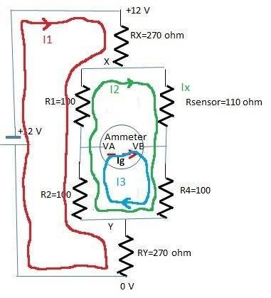

I am having troubles understanding how to calculate the current at RSensor when RSensor is 110 Ohms. Any help would be appreciated.

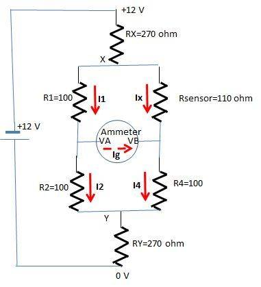

In my opinion, the actual Wheatstone Bridge circuitry is as in attached sketch.
In this case, the unknown 5 parameters will be I1,I2,Ix[through Rsensor],I4,Ig[through Ammeter].
The 5 equations are:
I1-Ig-I2=0
Ix+Ig-I4=0
I1*R1+Ig*Rg-Ix*Rsensor=0
I2*R2-I4*R4-Ig*Rg=0
I1*R1+I2*R2+(I1+Ix)*RX+(I2+I4)*RY=12
Neglecting Rg[Rg=0] Ix=0.008895 A
Using the loop method, only 3 equations are needed. Choosing the loop currents I1, I2 and I3 like this:

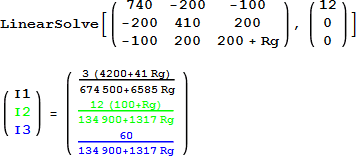

we then set up the 3 equations in matrix form like this, including the resistance of the ammeter Rg to obtain a more general solution:
I2 (green) is the same as Ix, and I3 (blue) is the current through the ammeter. Setting Rg = 0, we obtain Ix = 8.895 mA.
If the ammeter is missing (Rg = ∞), then Ix = 9.112 mA.
