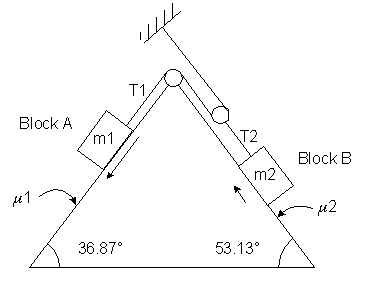

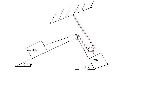

Homework Statement [/b]
am i right? please help me .. thnx
the blocks shown in the figure are connected by flexible, inextensible cords passing over frictionless pulleys. at A, the coefficient fiction is 0.30 while at B, it is 0.40. compute the magnitude and direction of the friction forces and each block.

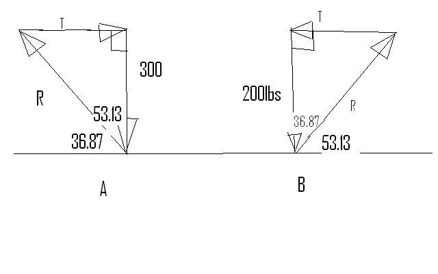

for block A=
T-mgsin53.13-Fmax=0
Fmax=0.3(300cos53.13)
for block B=
T-mgsin36.87-Fmax=0
Fmax=0.40(200cos36.87)
for A:
Fmax=μk(m1)gcos53.13
54=μk(m1)gcos53.13
μk=0.03
T-300(9.81)sin53.13-μk(300)9.81cos53.13=(300)a eq(1)
200g-T=200a eq(2)
subtitute (1) and (2) to find a
a=-3.79
for block B:
Fmax=μk(m2)gcos36.87
64=μk(m2)gcos36.87
μk=0.04
T-200(9.81)sin36.87-μk(200)9.81cos36.87=(200)a eq(1)
300g-T=300a eq(2)
to find a
a=0.2
AM i DOiNG RiGHT ?? please comment .. I am lack of knowledge ..
