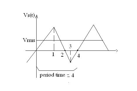

calculate the RMS (root mean square) of this function.
the period T=4
the formula is
[tex]V_{rms}=\sqrt{\frac{1}{T}\int_{0}^{T}V_r^2dt}[/tex]
[tex]V_{rms}=\frac{1}{4}4\int_{0}^{T}(4t)^2dt}[/tex]
[tex]V_rms=\sqrt{s}=\sqrt{\frac{16}{3}}[/tex]
the solution says that they divide the graph into 4 traingles
and they sum their areas
but they don't use the integral?
why they say (4t)^2
from where the 4t comes from?
why they say that its the root of the area
why they don't divide by the period?
the period T=4
the formula is
why they say (4t)^2
